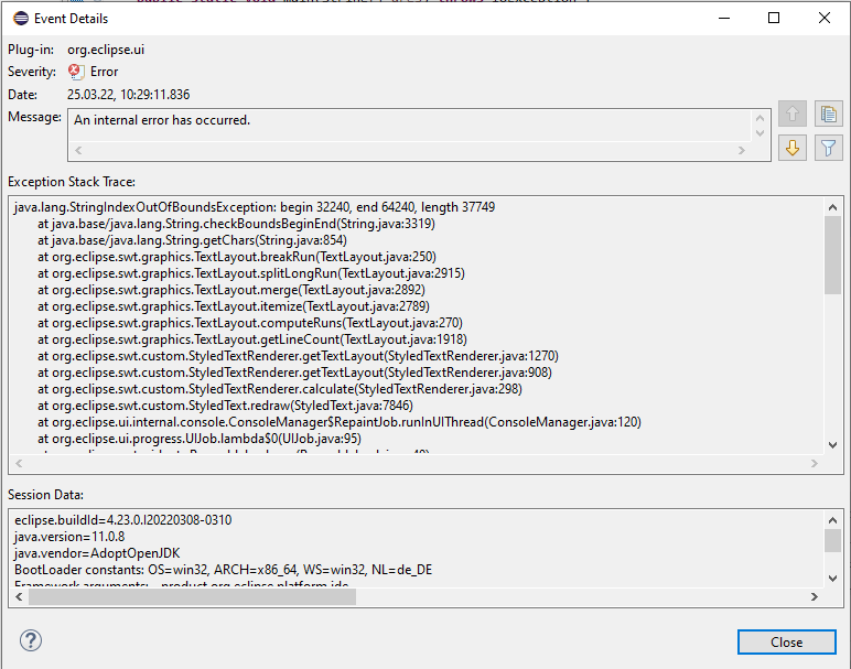

Console Plugin throws StringIndexOutOfBoundsException while printing. The Program is printing the log of a maven build. Nothing special.
This is new behaviour in 2022-03. My last working eclipse was 2021-09. I did not test 2021-12.
This error is easily reproducible with the code snippet below. Simply execute that programm with eclipse 2022-03 and you will see an error dialog popping up.
Also, please consider the comment. If printing the commented line instead, no exception is thrown.
