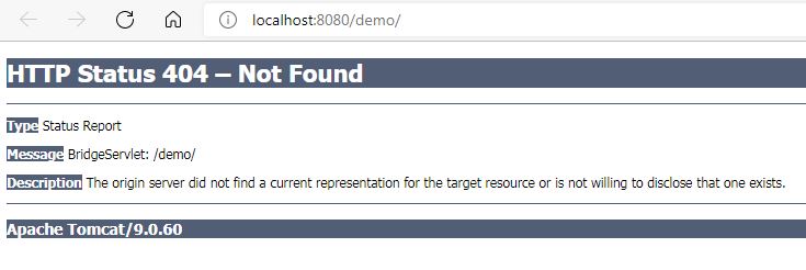

Dear all,
Environment:
Ubuntu 20.04 and Windows7 64bit
Jdk8u77
eclipse 4.7.3a
RAP 3.4sr2
demo.war(from org.eclipse.rap.demo.controls)
I imported source from org.eclipse.rap.demo.controls,and packed it as demo.war.
It works normally after deploying on both tomcat7.0.79 and tomcat8.5.64, but failed on both tomcat9.0.60 and tomcat10.0.18.
I tried over and over again with no luck, cannot figure out why not working?!
it's supposed to run on tomcat9 at least?!
In addition, my web service API works well on the 4 versions of Tomcat mentioned above!
I also checked catalina***.log, no warning/error message!
Please help!
Thank you in advance!

I finally found RAP 3.5 began to support Tomcat 9, and I am using RAP 3.4.
That's the reason!
