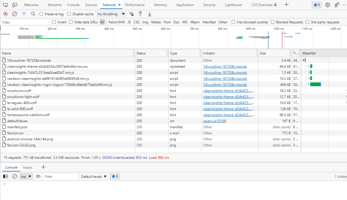

Attached is the Dev Tools output showing that the scripts and stylesheet resources are resolved.

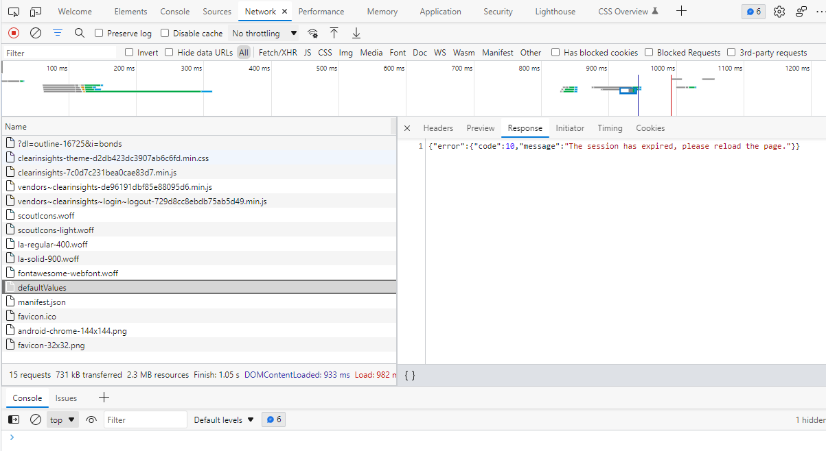

I have noticed that the 'defaultValues' request is returning with an error that the session has expired but if I refresh then the screen and 'defaultValues' remain the same.

Re: Migration from Scout 10 to 22 [message #1851176 is a reply to message #1851172] Tue, 29 March 2022 08:55 Go to previous messageGo to next message
You are writing that you set scout.devMode=true, but your screenshot shows minified files which should only be created and loaded in prod mode. So, are you actually trying to set scout.devMode to false? If yes, have you run the prod build before and copied the output to target/classes resp. set scout.loadWebResourcesFromFilesystem=true?

When forward request number 3 is encountered, ServletFilterHelper responds with the following JSON reply
{"error":{"code":10,"message":"The session has expired, please reload the page."}}
It seems that is where the processing stops and a blank screen is shown.

2022-03-29 16:53:57,777 DEBUG [qtp844112759-54] org.eclipse.scout.rt.server.commons.authentication.ServletFilterHelper.acceptForwardOrRedirect(ServletFilterHelper.java:345) - Returning session timeout error as json for path /defaultValues, based on Accept header application/json, text/javascript, */*; q=0.01. - MDC[]
