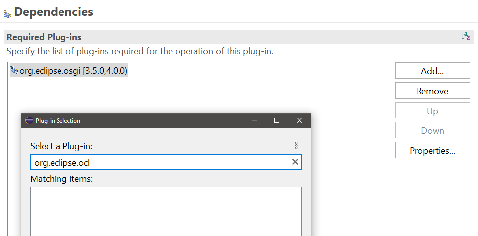

I need org.eclipse.ocl in my project, and I do have installed all the OCL SDK, however, when I click "Add" button in my dependencies page, I couldn't see org.eclipse.ocl

Your screenshot looks exactly like the MANIFEST.MF add dependencies, so it seems you are doing what I would expect. However I am somewhat at a loss to explain how nothing could appear.
Perhaps one of your "org.eclipse.ocl" characters is a non-ASCII look alike - unlikely.
Perhaps OCL is not installed. Try adding org.eclipse.emf, I suspect that too is missing. You could check Help->About Eclipse->Installation Details->Plugins to see what is really installed and Help->About Eclipse->Installation Details->Configuration to see what started.
I'm not sure where org.eclipse.osgi came from. I never declare it explicitly since it always comes in transitively. Perhaps you created a strange kind of project.
A ZIP of your project might shed some insights on whatever magic you have configured.
The Error Log might show something bad, or maybe you overlooked something while installing.
Bottom line. What you describe is 'impossible'. Something bad has happened.

Sorry for presenting insufficient information in my question. Now I have add org.eclipse.ocl successfully, but I don't know why. It's weird, I did install ocl SDK and everything, but seems it didn't work, and the ocl was installed from marketplace, so I removed it and installed it again from "Install New Software...". After doing that, org.eclipse.ocl could exist in the dependencies window.
