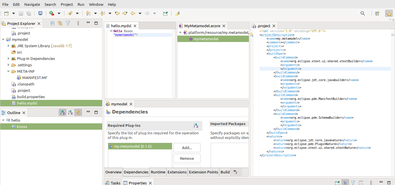

Re: Reference Epackage [message #1851081 is a reply to message #1851079] Sun, 27 March 2022 10:13 Go to previous messageGo to next message
index.php/fa/41815/0/
maybe you might also customize scoping similar as it is done for Xtext itself
there seems also a diff when projects use src folders or not.
you may bypass this using
public class MyDslUiModule extends AbstractMyDslUiModule {
	public MyDslUiModule(AbstractUIPlugin plugin) {
		super(plugin);
    public Provider<IAllContainersState> provideIAllContainersState() {
      return org.eclipse.xtext.ui.shared.Access.getWorkspaceProjectsState();
[Updated on: Sun, 27 March 2022 10:21] by Moderator
Re: Reference Epackage [message #1851085 is a reply to message #1851081] Sun, 27 March 2022 11:16 Go to previous messageGo to next message
Many thanks, it worked :)

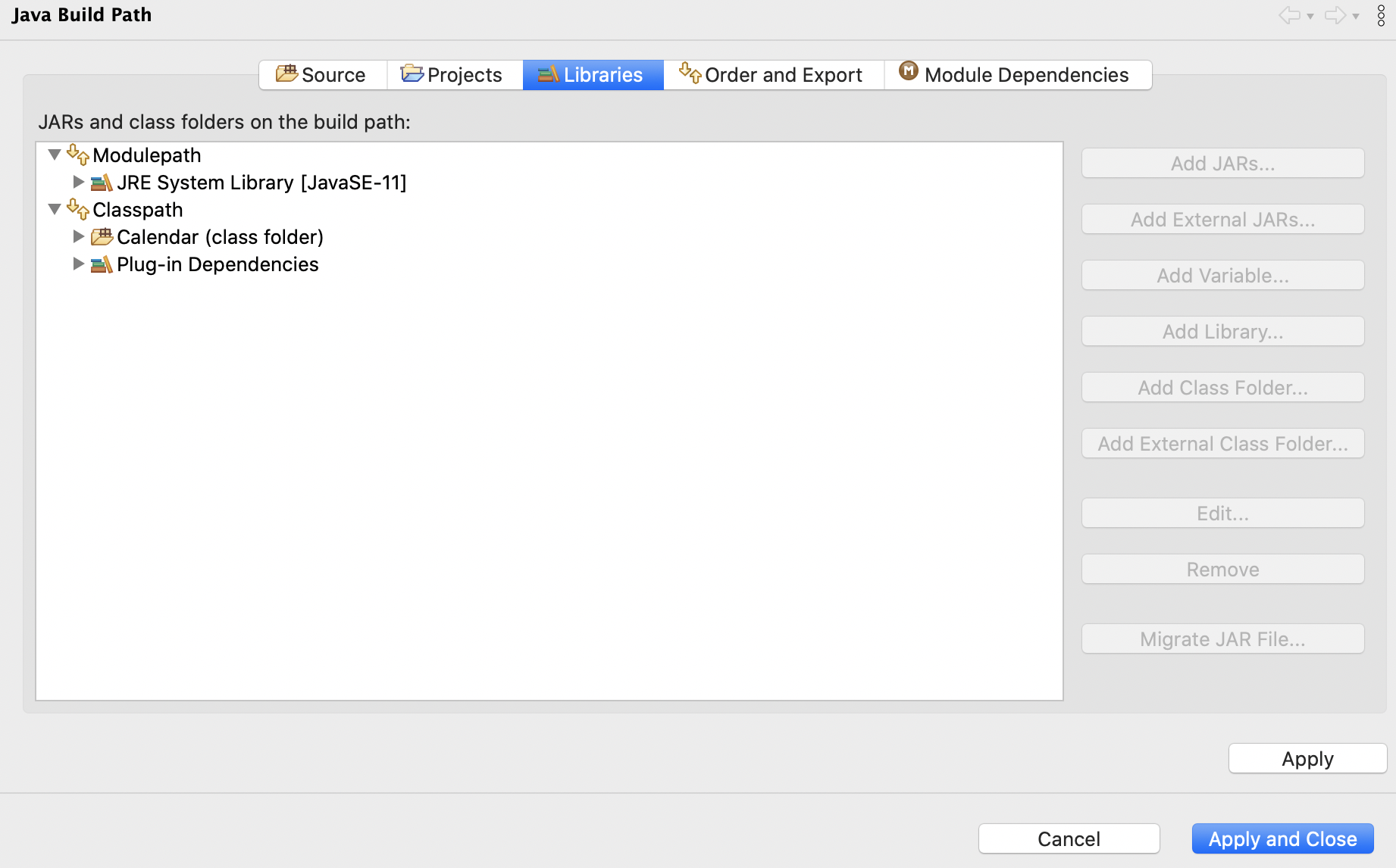

Unfortunately I am now having issues with eProxyURIs.
I added Library.ecore to the class path of the project where I have the concrete syntax of my textual DSL.
I also loaded the dsl in Xtend, as you suggested in my other post.
My Xtend code now looks like this.

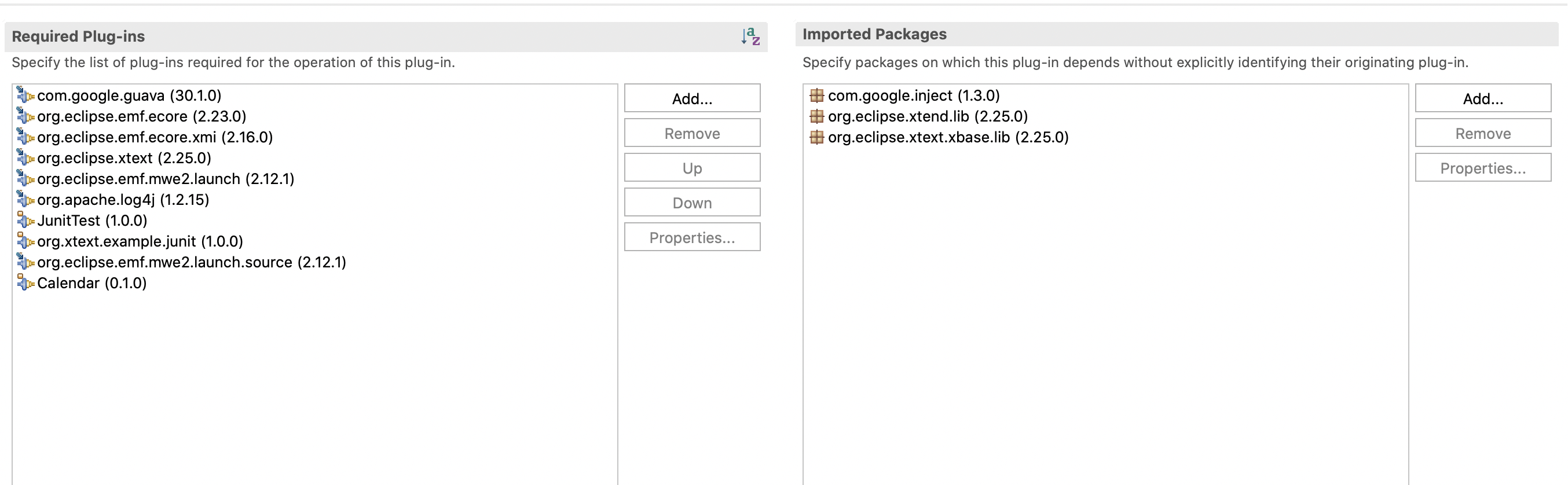

In the workspace I have another Ecore metamodel Calendar, which I also imported in the runtime and I added it to the class path of the Xtend project by using class folder.
index.php/fa/41824/0/
index.php/fa/41825/0/
I created the following instance of the grammar which is located inside the plugin. .
