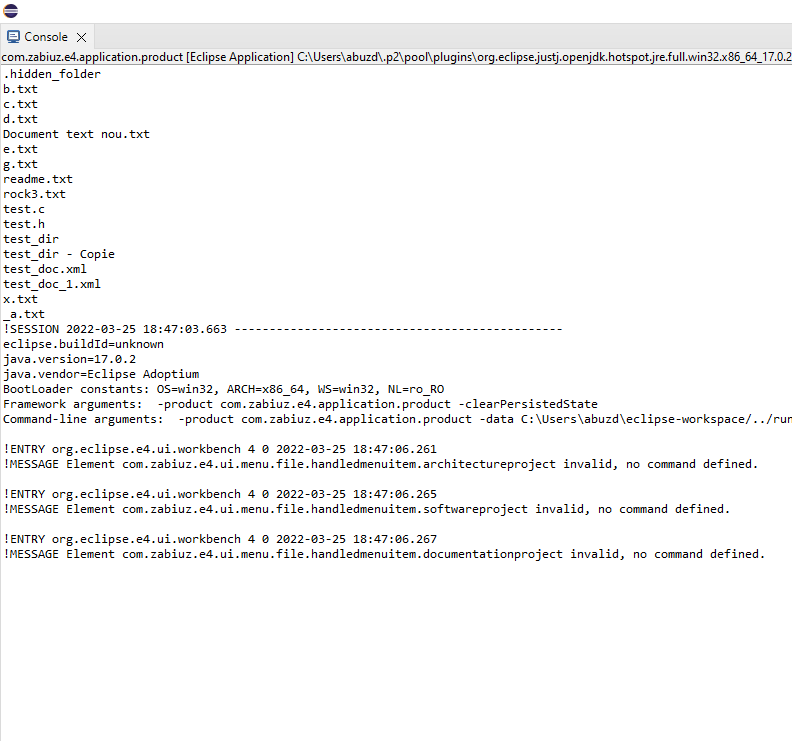

No exception. I've added a simple print in the catch block and it doesn't show.
  • Attachment: Captură.PNG
    (Size: 32.29KB, Downloaded 166 times)
Re: ITreeContentProvider with java.nio.file.Path; [message #1851051 is a reply to message #1851048] Fri, 25 March 2022 12:52 Go to previous messageGo to next message
Hard to say as there are many fields. But mostly is populated with paths of files in the selected workspace. For instance I've added a simple print, right before return, to check that I have the expected data there to work with and it;s okay, the array is populated with what files I have (ex : b.txt)
for (int i = 0; i < paths.length; i++) {
System.out.println(paths[i].getFileName());
    (Size: 32.29KB, Downloaded 171 times)

Followed advice, was hoping for a quick solution. Problem came from my side. In my original understanding, I thought that after getElements() function, the next one to be called is the hasChildren(). Not true for me, because I had a comparator functionality implemented. And that one wasn't handling the Path class, but the File class.
