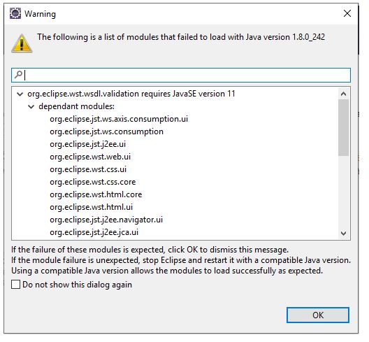

The reason I posted this question is that I'm seeing an error reported by one of the plugins that requires Java 11 to be installed. We are running Java 8 still, and cannot update any plugins to Java 11, which is why automatic updates is turned off.
Is there a way to determine which plugin is reporting this error? I attached it here.

Well, org.eclipse.wst.wsdl.validation only required Java 11 as of 2021-03, so you have a mix of feature versions
installed somehow.
Re: Prevent automatic install of plugins [message #1850987 is a reply to message #1850974] Thu, 24 March 2022 02:05 Go to previous message
The Error Log view will show which plugin fail to start because they need Java 11. This information is stored in <workspace>/.metadata/.log.
