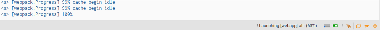

I finally got round the problem by updating the project using "Force Update....". However now when I try to run the app, the Webapp launch remains stuck at 63%
Any ideas what could be the problem?

this happens because the webpack build output has changed. You need to adjust your launch group. I've just added a section to the migration guide: https://eclipsescout.github.io/22.0/migration-guide.html#eclipse-launch-group

Thanks a million. Everything is now working. I love the new look.
