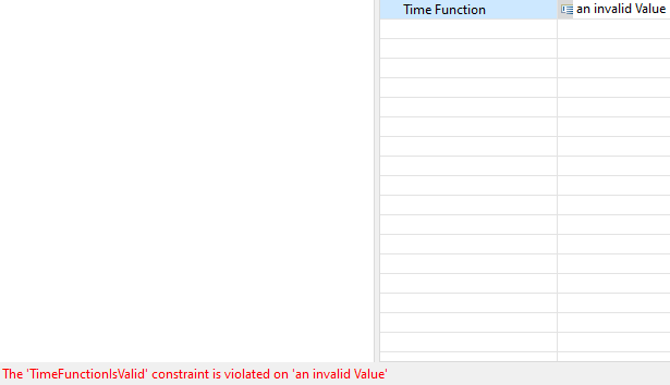

Sorry for the late response.
The default properties shown in the "Main" tab are dynamically infered using rules which do not take these constraints in consideration.
In theory I guess that would be possible, but this is not planned.
Overriding the default (infered) properties view with your own (see https://www.eclipse.org/sirius/doc/specifier/properties/Properties_View_Description.html) it might be possible to handle these with appropriate validation rules (see https://www.eclipse.org/sirius/doc/specifier/properties/Properties_View_Description.html#validation_rules in particular).
Pierre-Charles David - Obeo
