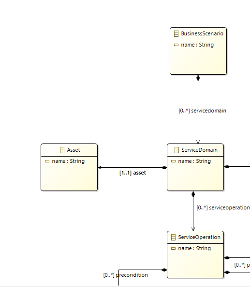

Hello, I followed the tutorial and wanted to make a node creating tool. The first one I made worked, which is a ServiceDomain, but the second one where i try to create an Asset doesn't work. When I try to use my Asset creation tool nothing happens. The full error is this:
org.eclipse.sirius.ecore.extender.business.api.accessor.exception.FeatureNotFoundException: asset on org.eclipse.sirius.bankingelements.impl.BusinessScenarioImpl@5f38dc75 (name: null)
I attached my metamodel. I use BusinessScenario as my root node.

Based on the screenshot and the error, it looks like your tool is trying to add an Asset directly to a BusinessScenario instead of a ServiceDomain. My guess is that you have the node mapping for Asset at the same level as the node/container mapping for ServiceDomain so your tool has the wrong container type on execution.
If it is not the case, can you attach your odesign or a screenshot of the mappings, node creation tool and its model tasks?

Yes, that was my problem. I thought I could do that and show all the elements in one diagram. I guess I cannot do that. Thank you for your answer.
