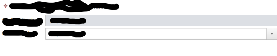

I'm discovering EMF Parsley. In my test, in need to know how to make a comboView not selectable (unmodifiable)
In the photo attached, you will find expected.
The first field (text field) is already unmodifiable and i need to do the same with the 2nd field (comboView).
Below the code for the 1st field
Instance: attribute -> { val t = createText("") t.editable = false t.setBackground(Display.getCurrent().getSystemColor(SWT.COLOR_WIDGET_LIGHT_SHADOW)) return t }
Someone has an idea ?
Oliver
  • Attachment: tempsnip.png
    (Size: 9.77KB, Downloaded 299 times)

I'm not sure I understand your question... you simply have to use the Java API of the combo view, just like you did with the text edit. Parsley simply relies on the Java API of the SWT and Jface controls.

Instance : attribute -> { val t = createComboViewer().combo t.enabled = false t.setBackground(Display.getCurrent().getSystemColor(SWT.COLOR_WIDGET_LIGHT_SHADOW)) return t }
target observeSelection()
-> field combo is not selectable but value is empty.
console stacktrace : "cannot be cast to java.lang.String"
Instance : attribute -> { val t = new Combo(parent, SWT.READ_ONLY) t.enabled = false t.setBackground(Display.getCurrent().getSystemColor(SWT.COLOR_WIDGET_LIGHT_SHADOW)) return t }
Instance: attribute -> { val t = createComboViewer().combo t.setBackground(Display.getCurrent().getSystemColor(SWT.COLOR_WIDGET_LIGHT_SHADOW)) return t }
I m not sure how to bind ?
Thanks for your help
