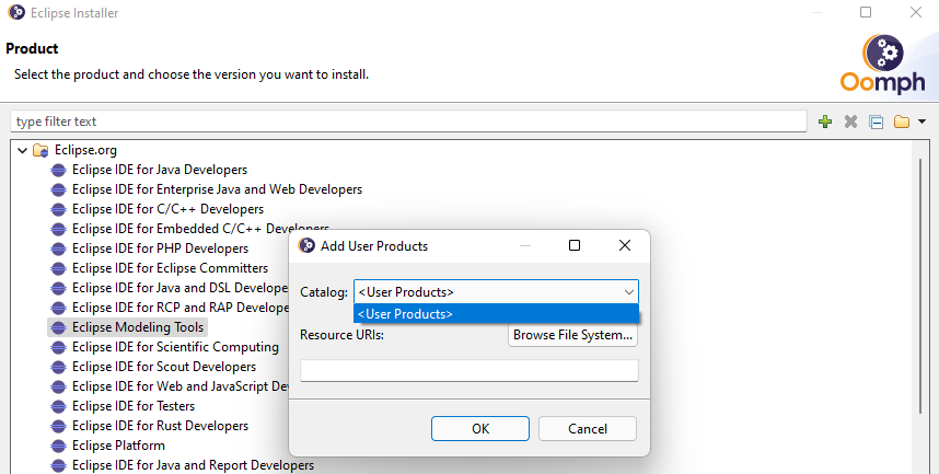

Re: Not able to add Github Project at Catalog [message #1849690 is a reply to message #1849687] Sat, 29 January 2022 14:52 Go to previous messageGo to next message
Ed,
Thanks for the quick reply. I did hit the "+" but when I do the drop-down dialog for catalog is populated only by the <User Product> item as shown in the attached screengrab.
Bjorn
Re: Not able to add Github Project at Catalog [message #1849696 is a reply to message #1849690] Sun, 30 January 2022 04:13 Go to previous messageGo to next message
See that the page you show is titled "Product"? But the page shown in their documentation shows Projects:
https://github.com/Systems-Modeling/SysML-v2-Pilot-Implementation/blob/master/oomph-projects.png
So you did not complete step 4 on the Product page such that for step 5 you are on the Projects page.
You should suggest to this project that they create a Configuration like what you can see for this project:
https://github.com/eclipse/windowbuilder/blob/master/CONTRIBUTING.md
Then all the steps they describe could be automated, e.g., including the choice of the Modeling product. I can help them if they ask. They can also ask to add their project setup to the Github catalog so that you don't need to add it manually, but they need to ask (i.e., open a Bugzilla to request that).
Re: Not able to add Github Project at Catalog [message #1849705 is a reply to message #1849696] Sun, 30 January 2022 12:10 Go to previous message
Aha. You brought me to my facepalm moment. I glanced ahead to the "+" icon on the page and did not realize you needed to advance the dialogs with the Next button to transition from Product to Project.
Thank you for the newbie assistance.
Bjorn
