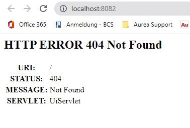

Unfortunately, when I want to start the applications and open the localhost URL I get the following 404 error.
index.php/fa/41591/0/
Besides that the servers seem to start just fine as there are no error messages in the console. I wonder if the problem occurs because of the version is 22 which as far as i know is in a beta status.

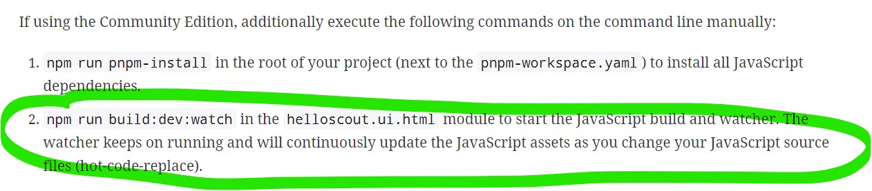

Awesome! You brought me to my mistake! It wasn't clear to me that the template was the same. What I missed in my contacts example was this step:
index.php/fa/41613/0/
I'm using community version of IntelliJ and it wasn't clear to me that these two steps have to be done for every new project. So my project was missing the entire "node_modules" folder and therefore it didn't work.
Pretty much a rookie mistake, I guess!
It works now just fine! Thanks again, Mat!

Yes, you are right. The JavaScript dependencies are required for each project (they are not global). Basically they could be different for each project (e.g. using scout 10 for one and using Scout 11 for another project). So for each project you have to execute pnpm-install and the watcher.
