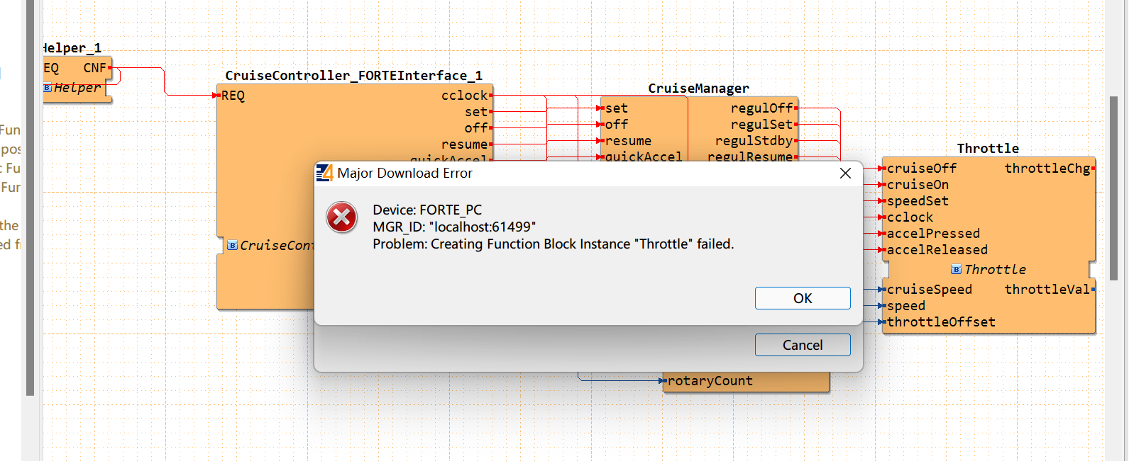

I'm updating my old version of 4diac to the latest 2.0.1, but I meet a problem when I'm using the Lua-based dynamic type loader. I choose the "DynamicTypeLoad" profile, and I compile forte source code by enabling the LuaJIT option. All necessary steps are done by following the document: https://www.eclipse.org/4diac/en_help.php?helppage=html/4diacIDE/dynamicTypeLoader.html
However, 4diac is stuck and pops up an error message:
index.php/fa/41586/0/
Everything is OK when I'm back to 4DIAC 1.13 and forte 1.13, with the same steps. My environment is Windows 11 x64, and the test 4diac project files are attached.

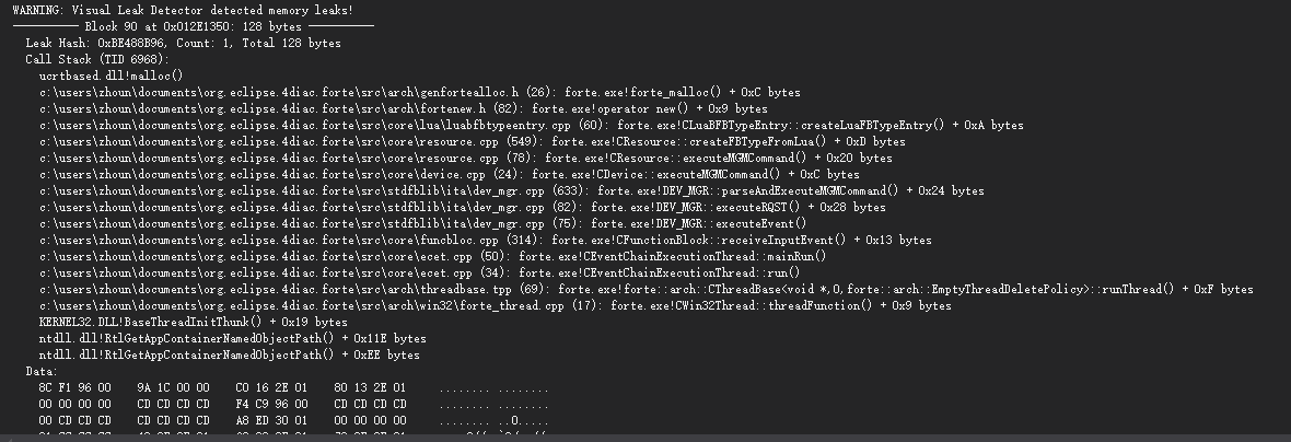

Last, I notice that each time a new FB type is created, a pointer to the instance of the CLuaBFBTypeEntry class will be created, but it seems that there is no call of its destructor function in forte, which leads to memory leaks when exiting forte. I've tested this problem in forte v1.13 using Visual Leak Detector on Windows.

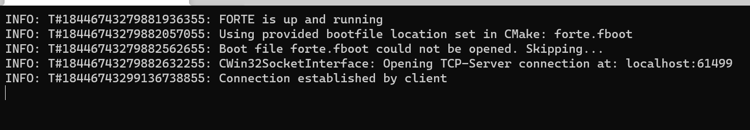

Do you have any additional information like output of 4diac FORTE, or deployment console?
Re: Dynamic type loader fails to deploy new FB Type [message #1849646 is a reply to message #1849644] Thu, 27 January 2022 11:04 Go to previous messageGo to next message
Thanks! Forte responds no error until deploying the FBType creation command. The output of forte and the deployment console during deployment is attached.
I also found that everything is normal when using 4diac 2.0.1 and forte 1.13. So, this may be a bug in the latest forte? I will have a try with other versions.
