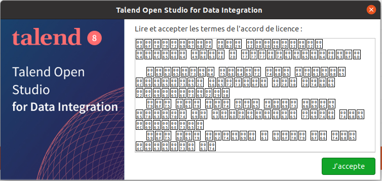

When I launch it I get the "license agreement" page and there is an encoding problem as shown in fig 1: index.php/fa/41570/0/.

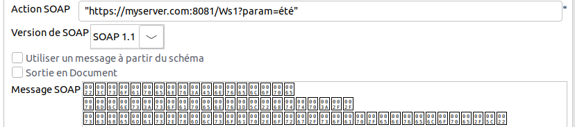

Using the app, I get the same issue in all multi-line fields, as show in fig 2 index.php/fa/41571/0/. I imported some project and ran it: it worked as usual, but the console log shows the same encoding problem.

That looks less like an encoding issue and more like a font issue. Does the same thing happen with Eclipse itself, and not just with Talend?
Re: encoding problem in Talend [message #1849497 is a reply to message #1849494] Fri, 21 January 2022 12:14 Go to previous messageGo to next message
No, in Eclipse I don't see the problem. For instance when I compile a maven package, the output in the console looks OK.
