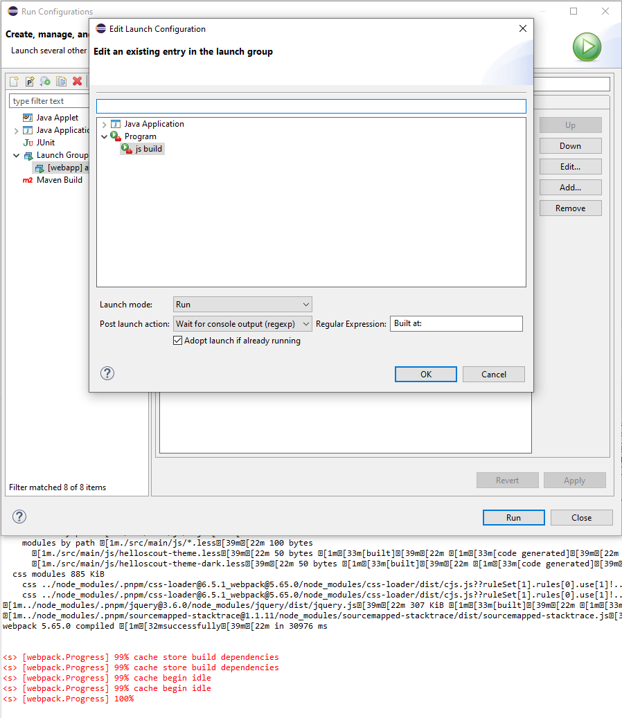

Also another issue with the new version is "[webapp] all.launch generates the js successfully but get stuck and does not start the server and ui.

I tried the 22 beta version and indeed there are some bug in launching the application : for me the launcher stuck at 63 % and does not complete the build , when I run the server and ui separately they run and load a newly beautiful ui.

thank you for the compliments. The launch gets stuck because the build output has changed, so the regex that triggers the launch of the ui and backend does not match anymore. It will be fixed in the next build.
https://github.com/eclipse-scout/scout.rt/commit/75a49ebe45586f424d08cf3183555a1312e4d626
