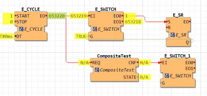

I create a Composite Function Block, but I get all "NA" in input/output, I'm not sure if I missing any operation, please suggest how can I get this composite Function Block work

Have you created the C++ code for your composite and compiled it into your 4diac FORTE version?
If you get NA most probably you will also see an error in the deployment console with UNSUPPORTED_TYPE.
PS: I see you are using an older version of 4diac IDE. I strongly recommend to upgrade 4diac IDE to the latest version 2.0.1
