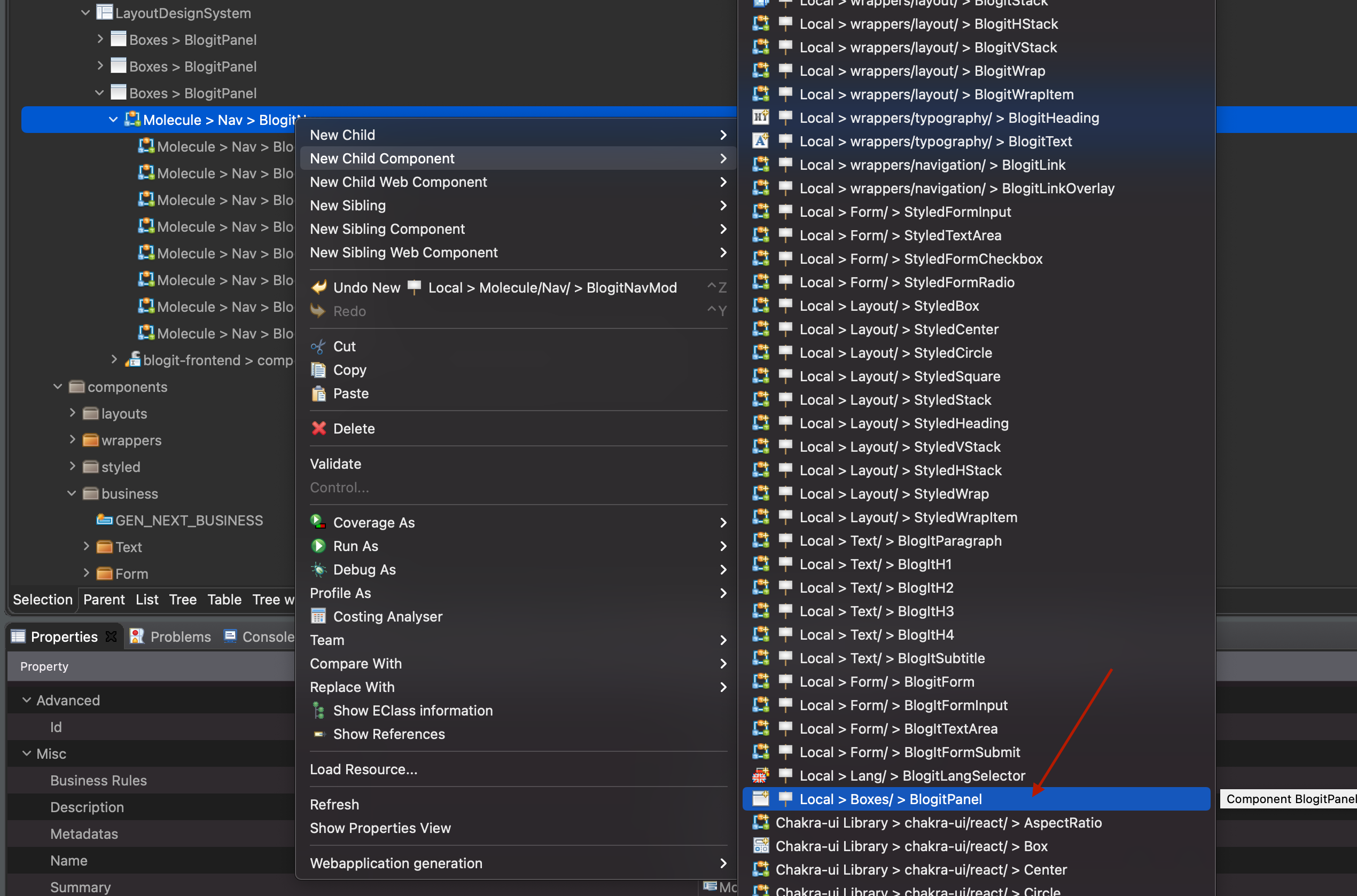

The need is to change dynamically the icon of some EObject that I will reuse in other part of the model, and display them in the add child or sibling menu.

This is fine, and I can get a lot of component in the child or sibling menu and some of them have a custom icon.

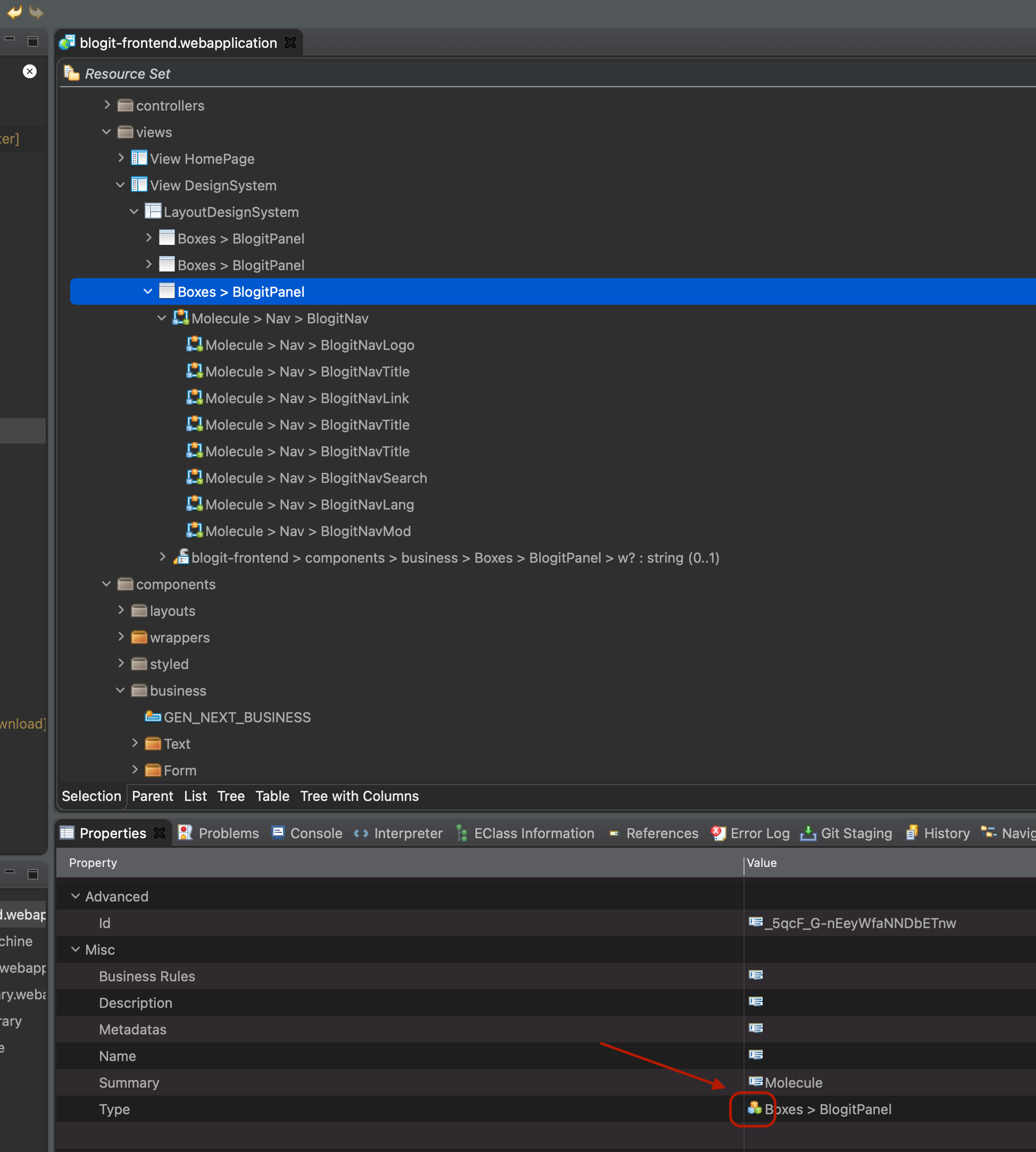

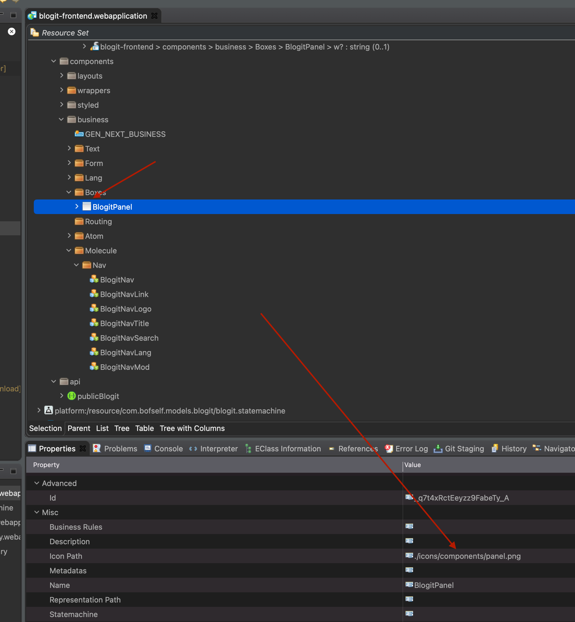

In fact, it IS working, but I seems that references in the properties panel do not have the right to display image from the workspace but only from plugins. (Please look at second picture).
Just trying to figure out if we can find a way to change this behavior.
