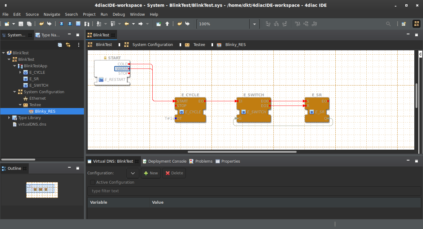

a complete newbie here. just installed the 4diac IDE and starting with the BlinkTest App. I do not see any option for the Deployment Perspective (the two cog wheels). Kind of stuck here and will appreciate any help.
Install version details as follows.
4diac IDE
Version: 2.0.1
Build id: 2021-12-29_1709
Host: SMP Debian 4.19.208-1, x86_64

we removed the deployment perspective some versions ago as it led to bed user experience. Unfortunately we were not able to update the documentation yet. Sorry for that.
The functionality of the deployment perspective can be found in two places:
1. for launching local runtimes we have the simulated device manager, which you can launch from the debug menu
2. for deploying your systems you need to select the element(s) to deploy (i.e., resources, devices, systems) and invoke deploy either from the run menu or from the pop-up menu

I was hoping to make progress and have logged a bug: Bug 578076
I am blocked by the situation as articulated in the bug. Additional advise how to progress is appreciated.

thanks for the bug report. Just to clarify this is not the deployment console but the console for the 4diac FORTE output. Unfortunately I have some issues with this console also on my system. I hope with the information I asked at the bug report we can trace this further down.
For your tests you don't necessarily need the simulated device manager. You can also start your 4diac FORTE instances from a console. with the command line param -c localhost:portnr (e.g., ./forte -c localhost:61500) you can specify any port number your 4diac FORTE should listen. If you don't give a value the default 61499 is taken.
