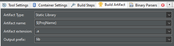

i have a strange problem with a static library C project. The builder always adds a .a extension to the name of the library.
as u can see in the attached picture the settings for build artifact are fairly standard and it works for my other colleagues, but on my installation of 2021-12
it generates a library called libshared.a.a with these settings. If i set the artifact extension to ext then the name of the genereated file is libshared.ext.a.
Can anybody point me to where this extra .a is comming from. My colleagues run exactly the same eclipse version and plugin versions.

yes of course, thats my problem. In the processes using the library there is
-lshared set. So the linker expects a file named libshared.a thats true. But the library project in eclipse cdt is build as libshared.a.a with the build artifact settings i posted which is just wrong. But thats only the case for me using the project not for other people in the team using the project. So it must be some eclipse setting or strange version. Thats why i'm asking if anyone knows help.

In version 2020-09 it shows "a" without the dot in Build Artifact > Artifact Extension (and builds OK).

i use 2021-12 but my colleagues use the same version. so i dont expect it to be a code related issue its more a configuration/workspace issue. But i have no clue where to look at. I try a cempletely new workspace but that did change the problem.
