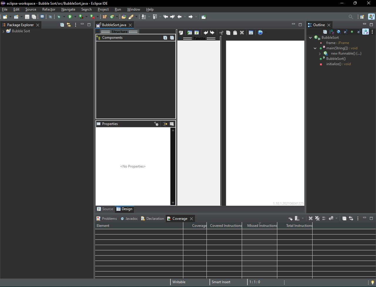

My windowbuilder is completely blank, I have no idea why. I have the right versions installed and everything, but It still shows up absolutely nothing. Could someone help me out? index.php/fa/41439/0/

Maybe it's like this issue:
https://github.com/eclipse/windowbuilder/issues/122
Adding --illegal-access=permit or --add-opens=java.base/java.lang=ALL-UNNAMED to the end of the eclipse.ini will help.
I think the latter is needed for Java 17 and the former is enough for older versions of Java.
But I also believe that the latest version shouldn't need these options so your problem might be different. If the option fixes the problem, please report back in the above issue. If the option does not fix the problem, please report a new issue. Please also look in the Error Log view for diagnostic information; in the quick search dialog (magnifying glass icon near the upper right), type Error Log to open that view.
