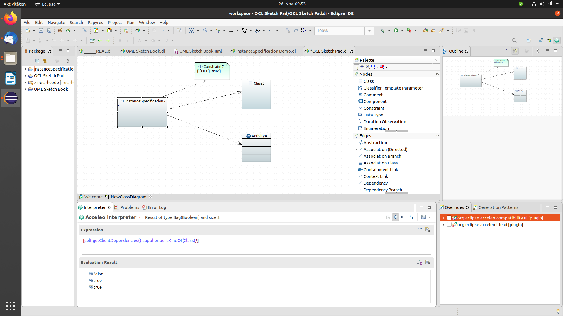

while researching the properties of Dependency ends and their types, I came across this discrepancy (see also the picture attached).
I have one InstanceSpecification1 with two Dependency Dep1 and Dep2, one leading to Class Class1 and the other to Activity Activity1.
When I apply oclIsKindOf(Class) on suppliers,
I got "truetrue" - it is not correct, one is Class and the second is Activity.
When I apply the same with Activity as input parameter, I got "falsetrue" correctly.
I think it's a bug, right?

I wrote these expressions into the editor and this worked out for me, which I copied as a screen.

the answer given by Acceleo is correct in both cases. You have to consider according to the UML specification an Activity is a Behavior which is a Class. Consequently applying oclIsKindOf on Class will also return true for an Activity.
Nevertheless, if I got your intention correctly you might can use a construct like:
[self.getClientDependencies().supplier->asOrderedSet()->reject(e|e.oclIsTypeOf(Class))/]
This gives you the non-conforming suppliers as an OrderedSet.
/Carsten

You are right about constructing terms in UML, but I think the given condition oclIsKindOf () examines a given UML specific for "leaf concrete metaclass".
To check , here is a listing of the XML file (.uml) of the given example, one element has type = Class and the second has type = Activity
