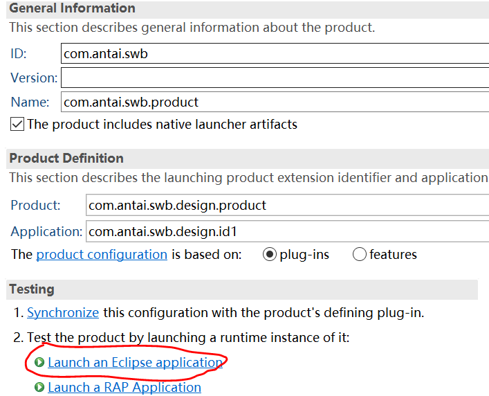

When I used "Launch an Eclipse application" to test a Sirius product, I encountered this stuck problem:
!ENTRY org.eclipse.sirius 2 0 2021-11-25 20:51:58.710
!MESSAGE The viewpoint specification model (platform:/plugin/com.antai.swb.design/description/swb.odesign) can not be loaded because it comes from a more recent Sirius release.
VSM version is: 12.0.0.2017041100
Last Sirius migration version is: 11.1.1.201610211630
!STACK 0
java.lang.RuntimeException: Can't deploy VSM in the viewpoint registry.
at org.eclipse.sirius.business.internal.componentization.ViewpointRegistryImpl$1.isValid(ViewpointRegistryImpl.java:124)
Some guys said that it can be solved by manually changing the version in a specific file, but it does not work for me. I am not sure if the correct file is not found or the location in the file.
anything I can do to resolve it ??
Thanks a lot !

I specified com.xxx.design.Activator.java as the extension of org.eclipse.core.runtime.applications and Application of the product. Because I compared this Activator class with the Application class of an usual RCP project, they both only contain start and stop methods.
Is this wrong? What should i do?
