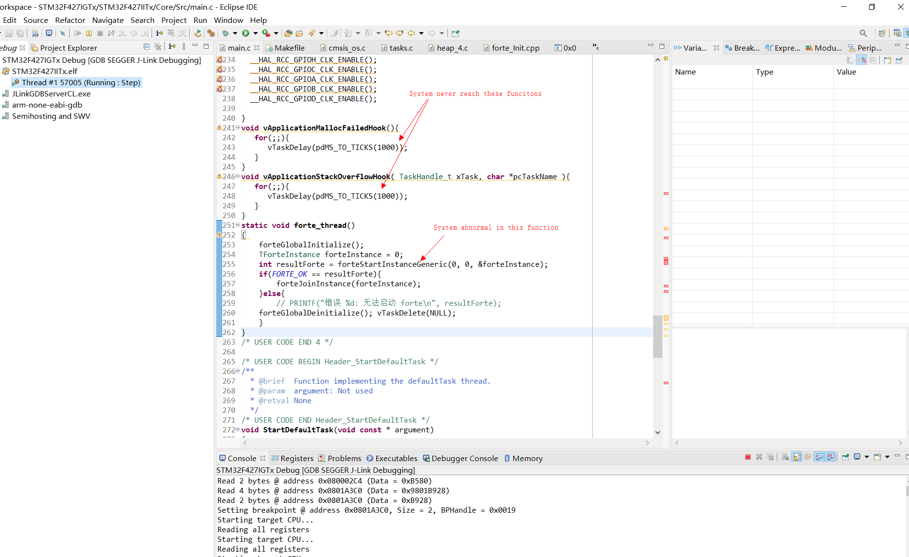

Unluckily, system seems abnormal when it run forteStartInstanceGeneric function. Please check attached log.
Also attached my main.c
Follow the tutorial instructions, I declare configCHECK_FOR_STACK_OVERFLOW and configUSE_MALLOC_FAILED_HOOK, but system doesn't reach vApplicationMallocFailedHook and vApplicationStackOverflowHook function
Is any friend know how to debug on this issue? Or how can I get into the function of the static library when debugging the main function, this may help me narrow the scope of the problem

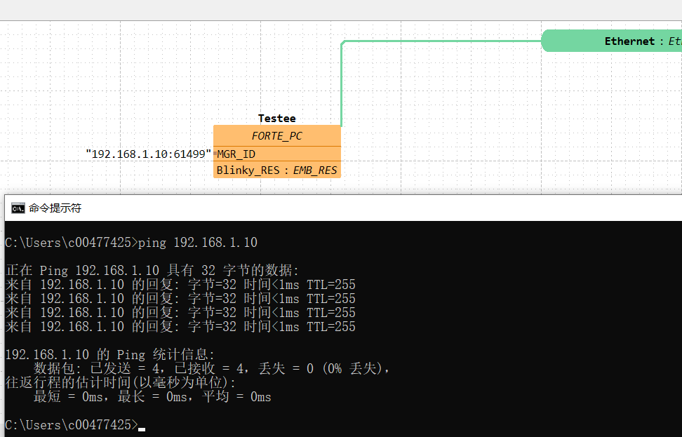

Now,I start LwIp, I use breakPoint, and see it runs into vApplicationMallocFailedHook, seems Malloc memory is not enough,and I set FreeRtos stack size to 1024 bit and heap size to 150kb, and memory issue doesn't appears.
The network is OK, I can ping my pc to STM32, and I can see the code enter forteJoinInstance function

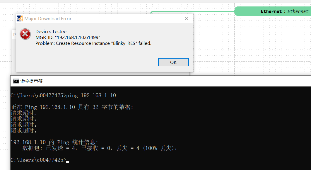

But when I connect 4diac IDE and forte engine, and deploy my blinkTest, it shows unable to create RES, and the network goes down
Does anyone encounter this kind of problem, or do you have any suggestions for troubleshooting?
