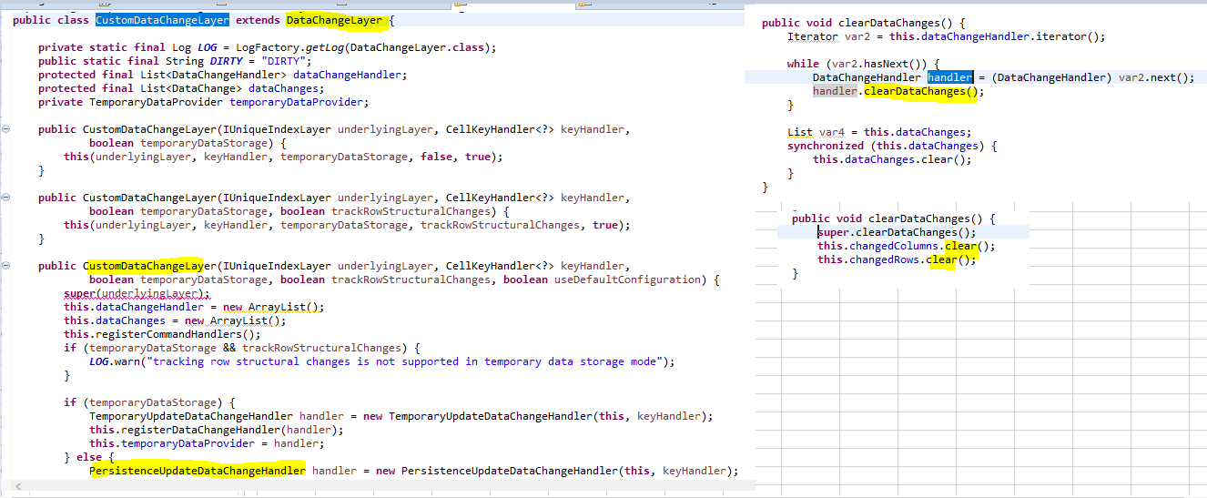

Re: How we can undo changes in Nattable like we did in excel? [message #1847999 is a reply to message #1847990] Wed, 17 November 2021 02:48 Go to previous messageGo to next message
I am unable to implement DataChangeLayer because of super call (please find attachment)
I want to override clearDataChanges method of DataChangeHandler(PersistenceUpdateDataChangeHandler is extending DataChangeHandler ) so need to implement DataChangeLayer so how we can achieve that ?
I have created CustomPersistenceUpdateDataChangeHandler (extending PersistenceUpdateDataChangeHandler ) so I can write my logic there, because now changedColumns changedRows will get clear but I want it should clear one by one.
Re: How we can undo changes in Nattable like we did in excel? [message #1848006 is a reply to message #1847999] Wed, 17 November 2021 06:10 Go to previous message
Sorry I don't get your point and why you want to override clearDataChanges. You simply have to implement a command handler that is undoing a single change.
