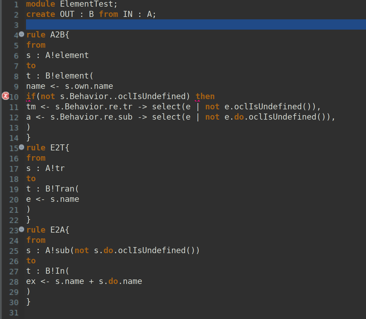

question about ATL [message #1847817] Tue, 09 November 2021 03:17 Go to next message
rule A2B{
from
s : A!element
to
t : B!element(
name <- s.own.name
if(not s.Behavior..oclIsUndefined) then
tm <- s.Behavior.re.tr -> select(e | not e.oclIsUndefined()),
a <- s.Behavior.re.sub -> select(e | not e.do.oclIsUndefined()),
rule E2T{
from
s : A!tr
to
t : B!Tran(
e <- s.name
rule E2A{
from
s : A!sub(not s.do.oclIsUndefined())
to
t : B!In(
ex <- s.name + s.do.name
I think this rule is right, but it also tell me Unable to access re on OclUndefined
so, can you tell me how to establish example
  • Attachment: file.xml
    (Size: 0.25KB, Downloaded 110 times)
Re: question about ATL [message #1847863 is a reply to message #1847817] Wed, 10 November 2021 13:09 Go to previous messageGo to next message
Your code has syntax errors. I don't understand how you're able to compile and run it (see attachment).
Your syntax error is caused by embedding imperative ATL code in the "to" part of an ATL rule, which is not supported. There are two ways to solve this:
1. Declarative - create a new rule that inherits from A2B, and includes "not s.Behavior..oclIsUndefined" in the "from filter expression. Move the bindings of "tm" and "a" into the new rule.
2. Imperative - add a "do" section to the A2B rule and move the "if" block into that section.
Re: question about ATL [message #1848007 is a reply to message #1847863] Wed, 17 November 2021 06:13 Go to previous message
Thank you for your answer, I don't know why my code does not show errors, I suspect it is because of my editor problem (I use eclipse)
Your answer helped me a lot, I will try this method to solve my problem, thank you
