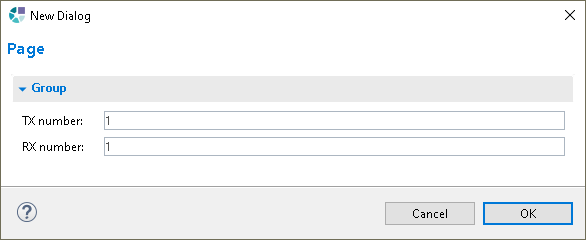

I have a container that must be configured before the displacement. This because the number of nodes to be added depends on 2 parameters. For doing this task I added a Dialog after the creation of the element where the user can set these 2 parameters: tx_number and rx_number.
I have two problems:
1) If I modify the textfields and I press enter the displayed values in the dialog come back to the default values whereas if I press the OK button the parameters in the object are correcly set.
How can I force the dialog to display the updated values?

I uploaded the screenshot of odesign view and the Dialog.

Re: Two problems with a Dialog for the Container Creation [message #1847685 is a reply to message #1847682] Wed, 03 November 2021 11:32 Go to previous message
OK I solved also the problem 2: I put in the text field property "Value Expression" aql:self.tx_number (or aql:self.rx_number) instead of fixed values
