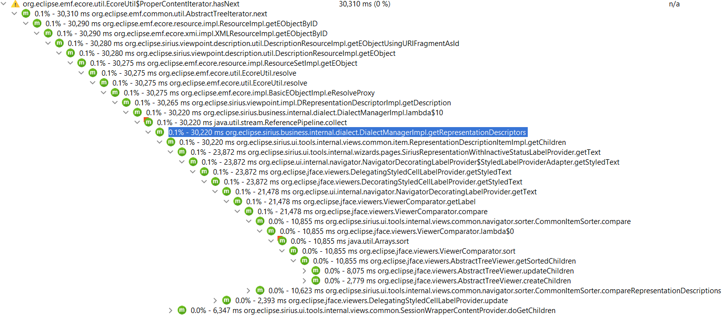

We have big enough odesign files (4 Mb). The problem is that the bigger odesign file is the slower Sirius works.
It seems that the problem with the following method:
org.eclipse.sirius.business.internal.dialect.DialectManagerImpl::getRepresentationDescriptors(RepresentationDescription representationDescription, Session session)
It's called a lot of times. Maybe it's possible to cache representation descriptors?

org.eclipse.sirius.business.internal.dialect.DialectManagerImpl::getRepresentationDescriptors(RepresentationDescription representationDescription, Session session) will scan all the representation descriptor in the session (in the .aird file), not the representation descripton (.odesign). So it will be more due to the number of representations created in your session than the number of representation description in your odesign. But anyway, I see your point, there might be some cache we could add to improve performances. Did this capture taking 30s happened in a particular scenario? Opening of a session or a representation? Restarting Eclipse with many representation opened in editors?

I think I've got it. The problem is caused by the aird-file editor. I mean the editor with 2 panes: a list of semantic models referenced from an aird, a list of viewpoints and representations. If the editor is closed then representation creation works very fast. But if the aird editor is opened, than it takes 15-30 seconds. This time is spent for the aird editor refresh. It's slow even if I create a representation using a context menu in a model explorer.
Also it takes a lot of time to open this editor, to enable a viewpoint, to create a representation.
We have about 250 representations in our aird. The file size is 120 Mb.
it seems not very critical, as I thought before, because we could just keep this editor closed :)
