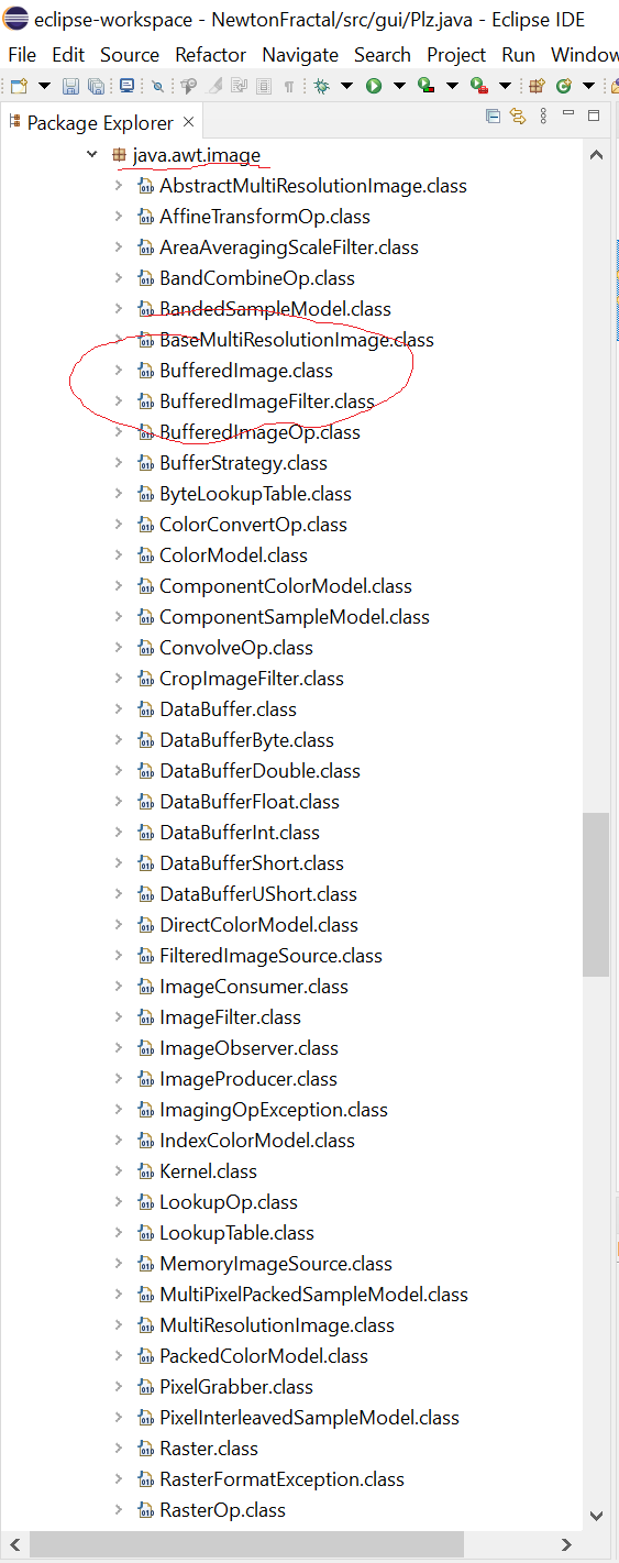

I'm using jdk17 and eclipse 2021-09. When I hover over a class and the menu pops up it doesn't show and option for import on classes in java.awt but will show that option for other classes.

I think this is controlled by Window -> Preferences -> Java -> Appearance -> Type Filters where most likely java.awt.* is check marked as filtered by default.
Re: Eclipse quick fix doesn't show awt classes [message #1847462 is a reply to message #1847449] Thu, 28 October 2021 03:13 Go to previous messageGo to next message
I don't see this behavior in my set up. To understand this better, can you tell me what happens when you organize import or manually add the import statement import java.awt.image.BufferedImage; ?
Does the compiler recognize that the classes are available from the classpath?
Or by any chance, is your project a Java module? If so, do you have "requires java.desktop" in your module-info?

Re: Eclipse quick fix doesn't show awt classes [message #1847483 is a reply to message #1847459] Thu, 28 October 2021 11:03 Go to previous message
Ed Merks wrote on Thu, 28 October 2021 06:19
This did it, thanks!
