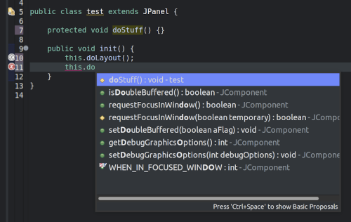

java content assist stopped working. At first it was just java.awt.* that stopped working, but it's getting worse. Now javax.swing.* has stopped working. This was working fine, just stopped yesterday.
environment: ubuntu 20.04 / Gnome 3.36.9 / eclipse 21.09
Tried:
  • Reboot
  • apt upgrade / reboot
  • Eclipse update
  • Eclipse restart
  • Create new workspace
  • delete all .index files
  • reset editor annotations to default
Picture shows some suggestions, but note how pretty much all are missing, at the minimum JComponent.doLayout() should be there
index.php/fa/41182/0/

Have you already checked your Type Filters preference page?
Re: Content Assist Broken [message #1847373 is a reply to message #1847350] Mon, 25 October 2021 11:01 Go to previous message
I checked Type Filters and they were set (unset) correctly. However it just started working again. No change, no restart anywhere, just started working again.
