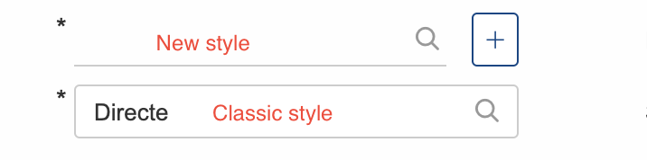

I see that we can set field to be displayed as on scout 6.x style with
setFieldStyle(IFormField.FIELD_STYLE_CLASSIC);
Is there a way to define the style for all fields in one place ?
I know that we can style the application with css, but i only want to have the classic look for all my input fields.
Thanks.

You could try to create an extension for IFormField. Something like:
public class MyExtension extends AbstractFormFieldExtension<IFormField> {
  public MyExtension (IFormField ownerField) {
    super(ownerField);
  public void execInitField(FormFieldInitFieldChain chain) {
    super.execInitField(chain);
    getOwner().setFieldStyle(IFormField.FIELD_STYLE_CLASSIC);
Then you can register the extension using a platform listener:
public class MyPlatformListener implements IPlatformListener {
  public void stateChanged(PlatformEvent event) {
    if (event.getState() == State.PlatformStarted) {
      BEANS.get(IExtensionRegistry.class).register(MyExtension.class);
Does this work?
Kind regards
Mat
Re: Classic field style for all fields [message #1847929 is a reply to message #1847785] Fri, 12 November 2021 18:47 Go to previous messageGo to next message
Thanks for your responses.
I tried the solution proposed by @Matthias and it worked. But the extension doesn't accept IFormField as bound parameter. I used instead AbstractFormField .
Thanks again.
Re: Classic field style for all fields [message #1847935 is a reply to message #1847929] Sat, 13 November 2021 13:58 Go to previous message
Hi Seydou, you are right, It needs to be AbstractFormField.
I'm glad it worked :)
