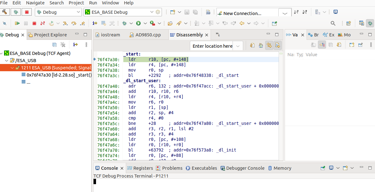

Does this makes sense?
When run using "Debug as -> Debug configuration - > Target Communication Framework -> (project ) Debug
the project stops at start of main - that is normal behavior to stop at the start of application being run in debug mode
"main" source file opens - in disassembly perspective- at first line . With exception of disassembly perspective all normal,
The stopping point is highlighted and I use an option to "Run to line " which
opens "main" source file - highlight first SOURCE line - and I can step thru the project source files as "normal " local application .
Basically does what I was asking for , albeit not to intuitively and round about way .
