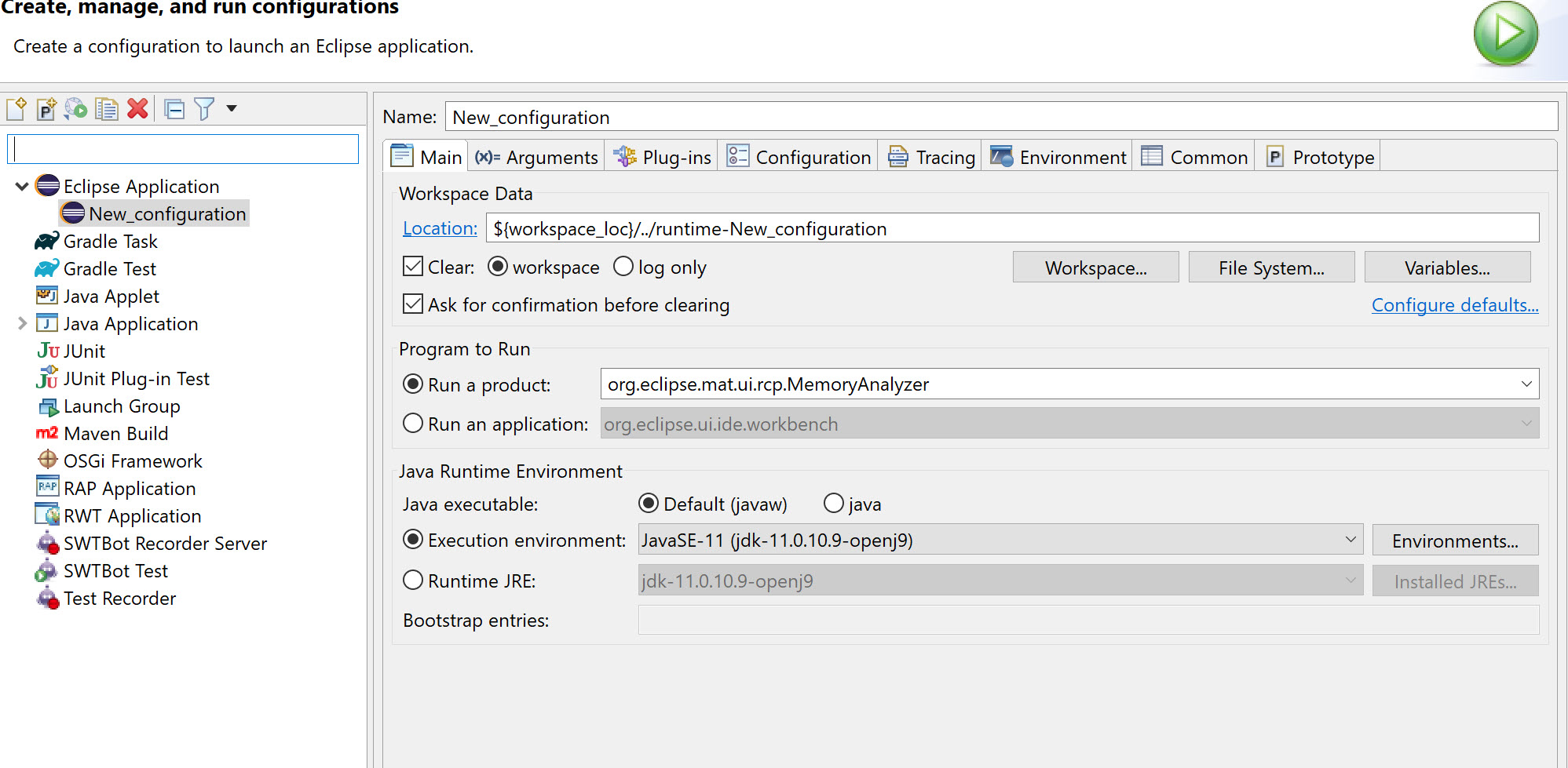

I'm trying to do the same process by analyzing an openj9 coredump file. Eclipse MAT reads the coredump file without any issues. However, when I enter debug mode in my Eclipse project, MAT opens a file chooser only recognizing .hprof or bin files. If I do "all files" and select my coredump MAT returns messages like:
Error opening heap dump 'core.10005.0001.dmp'. Check the error log for further details.
Not a HPROF heap dump (java.io.IOException)
Eclipse MAT, Open Heapdump File prompt returns a file chooser listing numerous formats including .dmp files.
I attached an example JPG showing my Run Config screen.
Any suggestions?

Is the org.eclipse.mat.dtfj plug-in listed in the debug configuration?
Are the IBM DTFJ plug-ins available?
Try using the mat-2021-06.target definition in the org.eclipse.mat.targetdef project for your target as that has the IBM DTFJ plug-ins.
Or, try importing the IBM DTFJ plug-ins into your target definition.
Or try importing the com.ibm.dtfj.api and com.ibm.dtfj.j9 plug-ins into your workspace and also add them to your debug configuration. Does the debug configuration validate properly? Go to the plug-ins tab and press 'Validate Plug-ins'.

I dropped the following two jars into MAT_HOME/plugins
com.ibm.dtfj.api_1.12.29003.202006111057.jar
com.ibm.dtfj.j9_1.12.29003.202006111057.jar
Restarted my Eclipse session, and stopped on a breakpoint. I'm surprised I need the two jars since I'd installed the IBM DTFJ plugin into Mat 1.12 environment.
