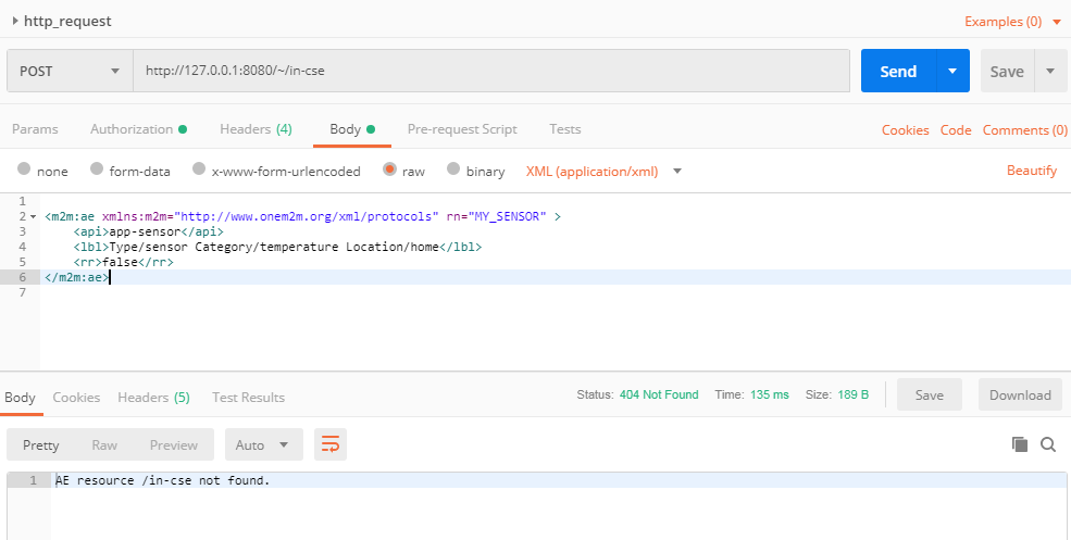

I failed to create "MY_SENSOR" application and I have this error : 'AE resource /in-cse not found'. Please find attached a printscreen of my postman post request. I need your help please. Thank you

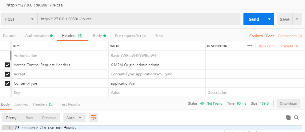

1/ Does the 1st part of the tutorial work? ("Retrieve a resource")
2/ Did you set the right headers:
X-M2M-Origin: admin:admin
Content-Type: application/xml;ty=2

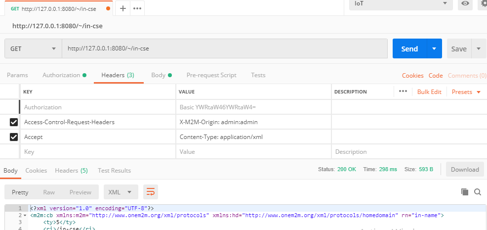

I have done successfully the 1st part of the tutorial work with correct headers. Please find attached a print screen. However, i fail to create MY_SENSOR application although I have used correct post request (headers, body, etc.)
