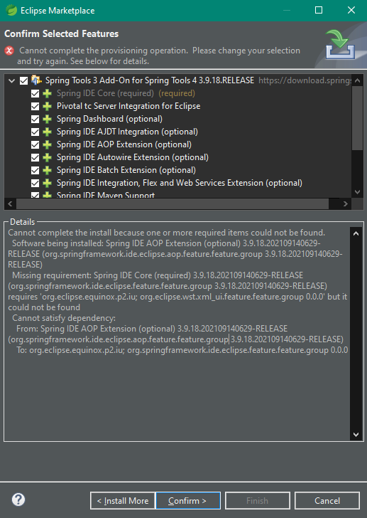

I do have connection with Marketplace. I can install others solutions from it, but when I try to install Spring Tools 3 Add-On for Spring Tools 4, I always get this error:
Cannot complete the install because one or more required items could not be found.
Software being installed: Spring IDE AOP Extension (optional) 3.9.18.202109140629-RELEASE (org.springframework.ide.eclipse.aop.feature.feature.group 3.9.18.202109140629-RELEASE)
Missing requirement: Spring IDE Core (required) 3.9.18.202109140629-RELEASE (org.springframework.ide.eclipse.feature.feature.group 3.9.18.202109140629-RELEASE) requires 'org.eclipse.equinox.p2.iu; org.eclipse.wst.xml_ui.feature.feature.group 0.0.0' but it could not be found
Cannot satisfy dependency:
From: Spring IDE AOP Extension (optional) 3.9.18.202109140629-RELEASE (org.springframework.ide.eclipse.aop.feature.feature.group 3.9.18.202109140629-RELEASE)
To: org.eclipse.equinox.p2.iu; org.springframework.ide.eclipse.feature.feature.group 0.0.0
Which may be the solution for this error? Am I doing something wrong or perhaps I have missed something?
I have uploaded an attachment with an screenshot of the error that I am getting.

Probably this feature is expecting you to be installing in the "Eclipse IDE for Enterprise Java and Web Developers" where this "missing" feature is already installed. In your Window -> Preferences -> Install/Update -> Available Software Sites is https://download.eclipse.org/releases/2021-09 in the list and checked (enabled)? In the worst case, use Help -> Install New Software..., choose/enter https://download.eclipse.org/releases/2021-09, look for "Eclipse XML Editors and Tools" and install that first.
