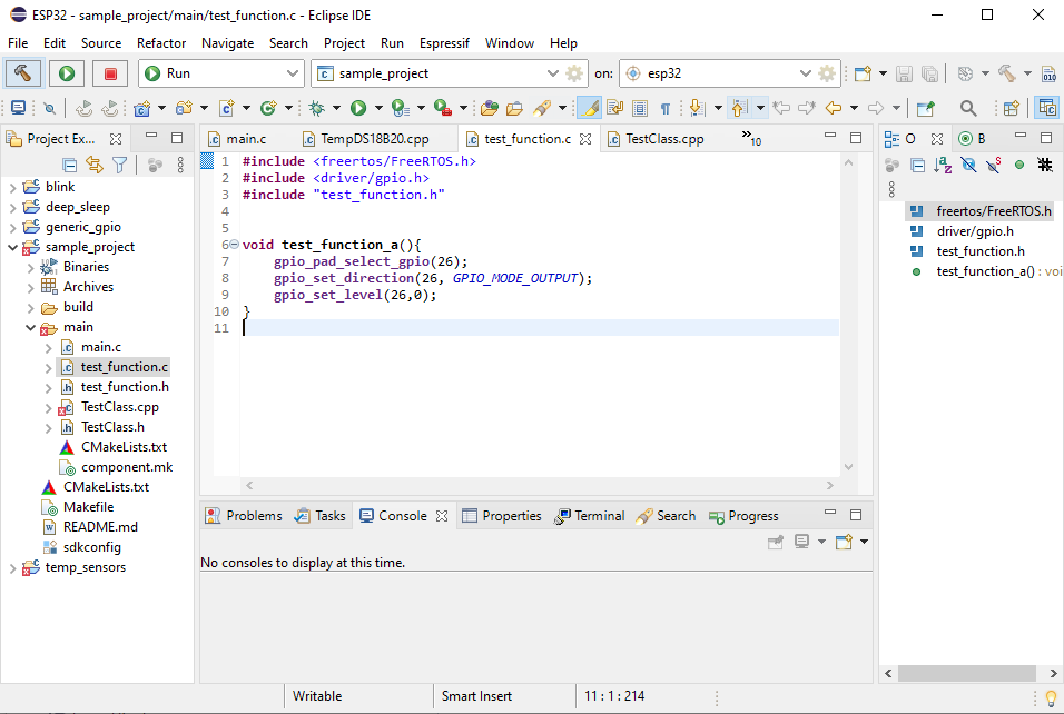

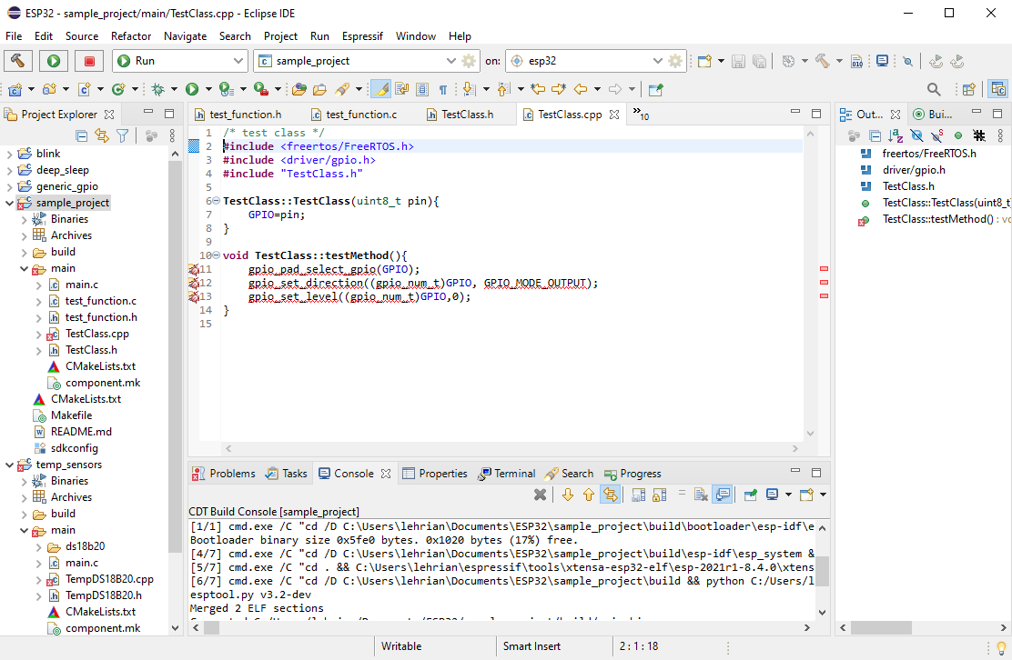

I'm having an issue with the indexer in a C++ file marking a method as "Invalid Arguments" however it is not as the file compiles just fine. Furthermore the indexer does not complain about the same code in a regular C file. This is using the ESP32 tool chain and I posted this to their forum and have received not response in a month so I thought I would try here. Here is Eclipse with the code in a C file:
index.php/fa/41075/0/
And here is Eclipse with the same code formatted in a CPP file.
index.php/fa/41076/0/

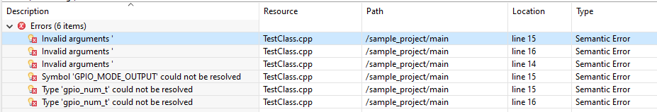

Re: Indexer marking method "Invalid Arguments"... [message #1845026 is a reply to message #1845025] Sun, 03 October 2021 13:39 Go to previous messageGo to next message
Thank you very much for your reply. I appreciate your help greatly. Here is the Problems Tab.

Re: Indexer marking method "Invalid Arguments"... [message #1845046 is a reply to message #1845026] Mon, 04 October 2021 10:16 Go to previous messageGo to next message
Check the header defining the symbols complained about. I do not know the ESP32 mess well enough to point to the right one.
As plain C goes fine but C++ does not, my guess is that there are extern "C" definitions missing in the affected header.

Interestingly, if I comment out
#include <freertos/FreeRTOS.h>
at the top of the C++ file the error markers in Eclipse go away the file file will still compile.

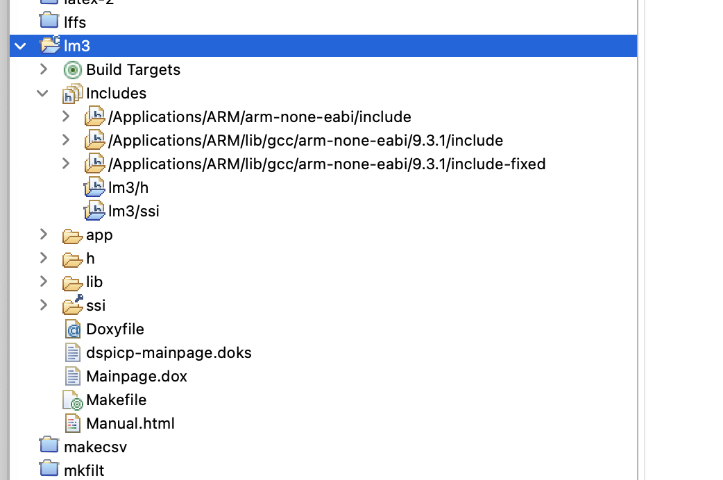

There are the Includes missing in the project setup, see picture.
index.php/fa/41108/0/
Open your project's Properties -> C/C++ General -> Preprocessor Include Paths, Macros etc, and click the language.
I see that your project is a CMake one. How did you set it up?

I found a fix! Apparently if I move the gpio.h import above the FreeRTOS.h import it fixes the issue. I don't know why, I was just hacking, but it works. I hate these kind of solutions, but it allows me to move forward.
#include <driver/gpio.h>
#include "TestClass.h"
TestClass::TestClass(uint8_t pin){
	this->gpio=pin;
void TestClass::testMethod(){
	gpio_pad_select_gpio((unsigned char)this->gpio);

So those includes are for ARM. This is an xtensa core which I believe is different. I don't have and ARM folder under the gcc folder in the expressif tools folder.
Re: Indexer marking method "Invalid Arguments"... [message #1845106 is a reply to message #1845103] Thu, 07 October 2021 03:04 Go to previous messageGo to next message
I took the Cortex-M3 project just to show how the includes directory looks.
You have two complications from an usual cross-compilation:
- the target processor is not the usual ARM or Cortex,
- the project has been set up with CMake.
It is pretty obvious that the indexer does not know the toolkit correctly.
Please open the project properties pages and check how your template has set up the compiler toolkit. For CMake, there are two good plug-ins in the Eclipse Marketplace:
- cmake4eclipse,
- CMake Editor.
The cmake4eclipse sets up its own entries in the project setup pages, and it is able to pick the details for the indexer, using the CMake scripts.
