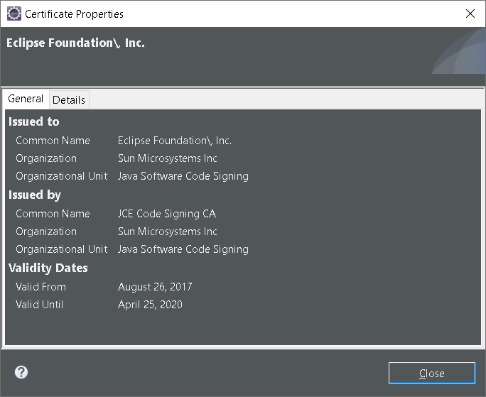

I'm trying to very generally update eclipse -- hoping to get the latest from 2021-09. However the process blocks with a Certificates Dialog asking me "Do you trust these certificates?". In the list there is one cert: "Eclipse Foundation\, Inc; Java Software Code Signing; Sun Microsystems Inc". When I open the "Details" dialog to check the certificate I can see that it is expired since April 25, 2020. Is this normal ? Should I be trusting expired certs just to upgrade Eclipse ?
Thanks in advance for any feedback.

Yes, it's unfortunately normal that old bundles that don't change for a long time are not resigned. I generate a report for the repositories release train repositories:
https://download.eclipse.org/oomph/archive/reports/download.eclipse.org/releases/2021-12/http___download.eclipse.org_releases_2021-09_202109151000.html
In that report you can see there are three bundles that use this certificate. The report doesn't include the validity dates which would be nice because then I would realize it's a bit problematic.
In any case, a securely signed jar doesn't become insecure on the day the certificate expires...

Thank you Ed Merks,
That calms the majority of my worries. I'll resume my upgrade then!
Sub-question would be how the certs are used to imply validity -- anything I can read on the subject ? In any case, I'm assuming a malicious party can't acquire these expired certs and re-sign their own jar so we're good in that respect. Cheers.
