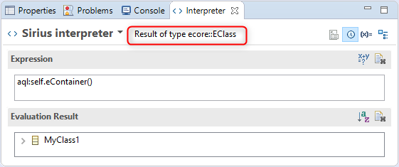

If you use the "Interpreter" view, what is the result type of expression "aql:self.eContainer()"? The type is displayed in the "title area" just after the combo to select "Sirius interpreter": index.php/fa/41016/0/
