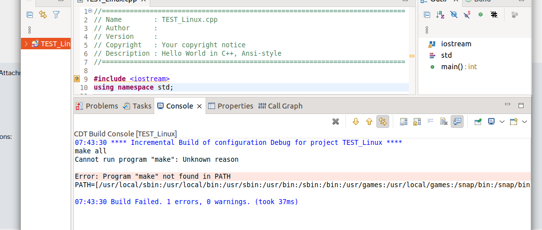

Fresh clean down;load / install of 2021-09 CDT won't compile "right from the box" - missing access to "make".
I have never in past experienced such failure after new . clean install.
index.php/fa/41001/0/
EDIT
OK, Eclipse in missing CORRECT path to "make" .
How do I find it FOR eclipse and how and where I change / add correct path?
[Updated on: Fri, 17 September 2021 11:16] by Moderator
Re: 2021-09 - no path to "make" [message #1844622 is a reply to message #1844609] Fri, 17 September 2021 14:56 Go to previous message
Please write on the shell:
which make
and have a look on the response if the directory is in the PATH shown on the message.
Another possibility is that there is no make program installed.
I guess that you're using a Debian derivative (Ubuntu?). Install the build-essential package to get the make program.
