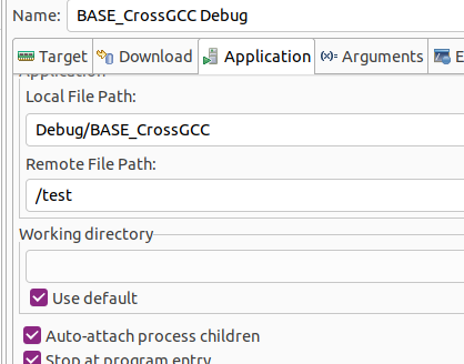

1. Should I be able to "find" -name "*BASE*"
somewhere on my RPi?
2.But it miraculously "runs" AFTER I implement "Application" " Remote File Path"
... any path, even "/" empty .
So what gives ?
Re: Success ... but more questions [message #1844475 is a reply to message #1844469] Tue, 14 September 2021 13:04 Go to previous messageGo to next message
If you enter both Local and Remote file path, TCF will copy (download) the file from Local to Remote every time you launch the debug session.
> Should I be able to "find" -name "*BASE*" somewhere on my RPi?
No, because you entered "test" as the Remote file name, not "*BASE*".
I'm not sure what you mean. Remote file path cannot be a directory, it should be a file.
Re: Success ... but more questions [message #1844481 is a reply to message #1844475] Tue, 14 September 2021 19:49 Go to previous message
Eugene Tarassov wrote on Tue, 14 September 2021 17:04

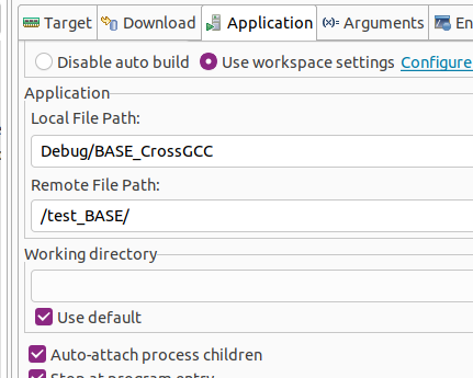

OK, let;s recap.
There are these entries
1. local "file path" ( Debug/BASE_CrossGCC) which is hardly a "path" because it includes the actual file name.
But that works.
2. Remote "file path" which makes no sense because just "/" will enable "run" button and it will execute on the RPi.
3. Then there is a "remote directory" which has option of "default" , and same as above item 2 - the app runs on RPi with default.
The cross linker clearly identifies the object file and I cannot "find" in on the RPi.
Now to make it more interesting - in "TCF debug" configuration I get "TCF process console " and so far I have no idea where does it come from - it is "automatic" . It does "print" all stuff coded ....
And I believe there is "by the way" a note which said that this "TCF process" has to run/ be implemented on the target.
All this makes implementing TCF such hit and miss, but I still believe resolving all of these by giving reasons why - would make Eclipse and TCF a great tool to make Raspberry really shine.
Funny part - this has all been discussed before , but my personal RAM is not that great anymore...
yes, I kept notes ....periodically destroyed by new and "improved " OS
Cheers
