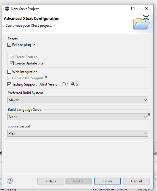

I try to create an Eclipse product from the standard example DSL by using the wizards in Eclipse to create an XTEXT project.
I create the mydsl projects with the options 'Eclipse plug-in', 'Create Feature', 'Create Update Site', 'Testing Support', 'Maven', 'None' and 'Plain' (see also the attached picture wizard.png).
After I run the MWE2 workflow, I can then run the Eclipse application from Eclipse (Run As > Eclipse Application).

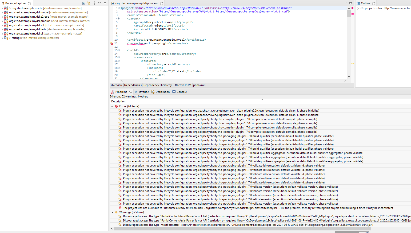

However, within Eclipse it looks not so good (see attached picture). Lots of complaints on the pom.xmls (plugin execution not covered by lifecycle configuration ...)

Re: Unable to create Eclipse Product from the sample MyDsl projects [message #1844472 is a reply to message #1844466] Tue, 14 September 2021 12:08 Go to previous messageGo to next message
Then you either need to install additi8nal m2e connectors to your eclipse
(There should be a Quickfix)
Or simply ignore them
Or add exclusions to Pom
But these errors are not related to your problem of building a product
