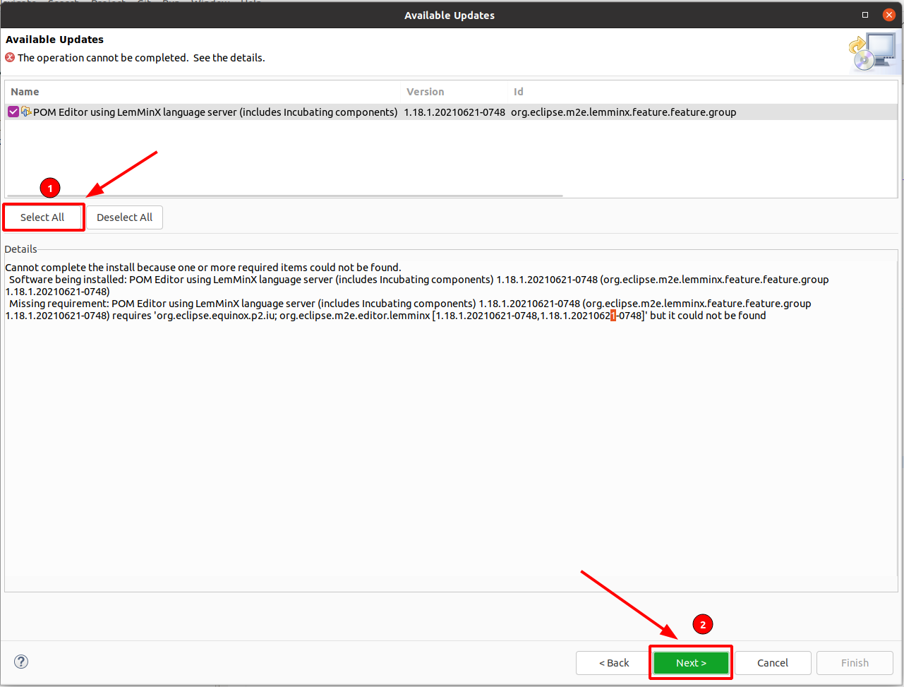

When I tried to update Eclipse, I encountered the below message, I cannot seem to find the solution even on Google (unless I am not searching for the right key works -- mainly because I could not figure out what to search for , apart from I tried to split the error message and separately searched for it )
Cannot complete the install because one or more required items could not be found.
Software being installed: POM Editor using LemMinX language server (includes Incubating components) 1.18.1.20210621-0748 (org.eclipse.m2e.lemminx.feature.feature.group 1.18.1.20210621-0748)
Missing requirement: POM Editor using LemMinX language server (includes Incubating components) 1.18.1.20210621-0748 (org.eclipse.m2e.lemminx.feature.feature.group 1.18.1.20210621-0748) requires 'org.eclipse.equinox.p2.iu; org.eclipse.m2e.editor.lemminx [1.18.1.20210621-0748,1.18.1.20210621-0748]' but it could not be found
PS: (About attached photo)
1) by default the update is selected, but 2) the 'Next' options is not available
I need to click 'Select All' to make it available
2) even after it becomes available, when I click on 'Next' nothing happens
I don't know how much are this two issues related to each other, wanted to provide additional info.
>>>>> HAS ANYONE EVER ENCOUNTERED THIS ISSUE AS WELL?
Can you please share how you resolved or if you happen to know the solution, how should I resolve this issue?
Thanks a million in advance!

Re: Cannot complete the install because one or more required items could not be found. [message #1844467 is a reply to message #1844440] Tue, 14 September 2021 10:19 Go to previous message
Are you using current Eclipse installer ?
https://www.eclipse.org/downloads/packages/installer
I had some issues getting Ubuntu 21.04 "run" the installer.
I ended up downloading for Windows...
In past weird issues like your was using the "official mirror" and selection "all sites" for update....
