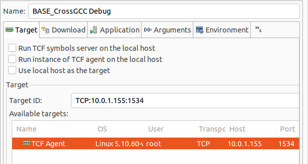

Sorry, I did find the "new" git "agent" but forgot to add it here.
Eugene - can I ask for another favors ?
I have been using the old TCF about two years ago and forgot how to actually configure Eclipse.
I know I can use "default file" , but forgot what goes to "application"....
I can finally cross-compile but do not have copy of the executable on my RPi, maybe because of the above is missing.
Basically - how do I check if the agent is actually running on the RPi?
I would eventually like to use another IDE with TCF, but I need to get it going with Eclipse first.
Thanks for your help, appreciate that very much.
