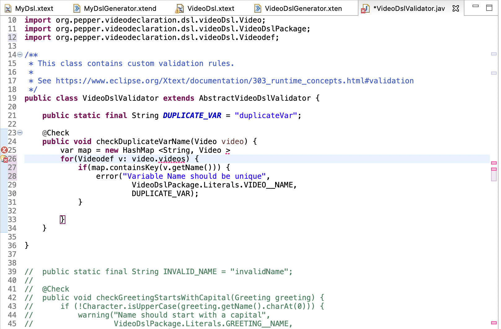

Hi, I am writing a validator to avoid repetition.
Variable names should be unique.

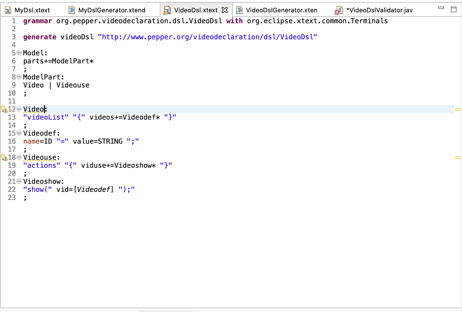

In the grammar screenshot (attached below), the "videos" variable should always be unique.
In the other screenshot, I tried to write the custom validation rule for it. Please see the validation file screenshot and guide me, what I have to do. I am new to Xtext and confused about how to write the correct code for it. Thank you.

Re: Validator [message #1844297 is a reply to message #1844282] Wed, 08 September 2021 07:24 Go to previous messageGo to next message
Do you mean that I have to write this repetition check in the dslgenerator.xtend file?
Below I have modified the validation file. Please have a look and guide me because I am confused in this.
@Check
public void checkDuplicateVarName(Video video) {
///var map = new HashMap <String, Video >
Set<String> existing = new HashSet<>();
for(Videodef v: video.getVideos()) {
if(!existing.add(v.getName())) {
error("Variable Name should be unique",
VideoDslPackage.Literals.VIDEO__VIDEOS,
DUPLICATE_VAR);
[Updated on: Wed, 08 September 2021 07:37] by Moderator
Re: Validator [message #1844302 is a reply to message #1844297] Wed, 08 September 2021 09:28 Go to previous messageGo to next message
@Check
DUPLICATE_VAR);
Hello, From the above code, error always appears on the first line.
How can I add the error message to the line on which we are writing the duplicate variable?
[Updated on: Wed, 08 September 2021 09:29] by Moderator
Re: Validator [message #1844316 is a reply to message #1844302] Wed, 08 September 2021 14:02 Go to previous message
You can call the overloads of
Error that also take an eobject and estructuralfesture
You can pass v as eobject
And YouOackage.literals.videodef_name as feature
