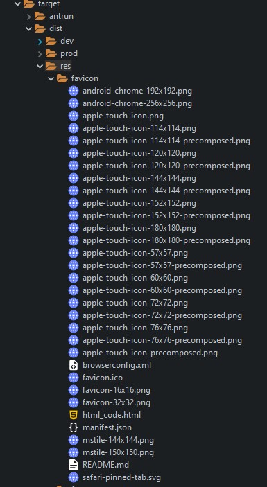

I recently upgraded to Scout 11. I already had a similar Error 404 but that was resolved by deleting the node folder. Now i have the same Error code but for a different resource. For some reason after i log in (only sometimes), the browser goes to that Url:
https://localhost:8000/res/favicon/android-chrome-192x192.png
and then gives me an Error 404.
But it exists in the target folder as shown in the screenshot.
But i dont know why he dosn´t find it.
The even weirder part is when i delete the /res/favicon/android-chrome-192x192.png from the url, i can get to the application like nothing happend and everything works fine. It also shows that favicon.
Has anyone an idea?
Thanks in advance :)
Edit: ok i solved it. Apperantly i didnt adjust the paths of the favicons in my head.html. It was still on res/favicon/ which should have been favicon/ . As soon as i fixed that everything worked
