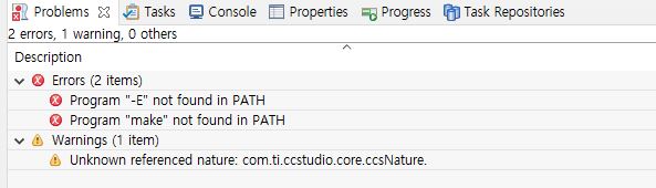

I am getting the attached problem now. Console says 'Build not configured correctly"

Re: Unknown Referenced Nature [message #1844209 is a reply to message #1844197] Mon, 06 September 2021 07:24 Go to previous messageGo to next message
Well, that's a different problem.
The unknown referenced nature likely means
whatever plugin is expected for ccs is not installed.
And the build is now trying to use the external builder "make"
instead of the internal builder which you used before.
You probably will need to install "make" for MinGW.
You must have changed something. What was it?
Can't help you on the plug-in.
I'm guessing maintenance on it stopped about 10 years ago
and probably won't work with the newer CDT versions.
If you are going to use a current version of Eclipse/CDT with this code
you'll have to figure out how to migrate it to standard CDT
and forego any plug-in
Or switch to a standalone CCS if you can find it.

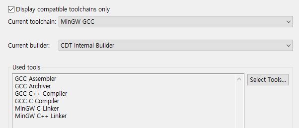

At project>properties> C/C++ build>Builder setting , I can see builder type is written as internal and pop up is inactivate, I cant click on it.
I already installed MinGW. What kind of 'make "need to install?
I have change tool chain setting. see the attachment.

Re: Unknown Referenced Nature [message #1844236 is a reply to message #1844235] Mon, 06 September 2021 21:52 Go to previous messageGo to next message
The Texas Instruments Piccolo F2806x architecture is unlikely the same
as the one you are using to run Windows and MinGW. In fact, it looks to be a
C28x device. You'll have to find a compiler and linker for it and learn to use it
from the command line. Then you can tell Eclipse what to do with it.
That's probably why there was a plug-in for it.
Try a web search for F2806x compiler
Maybe here? https://www.ti.com/tool/C2000-CGT
or? https://software-dl.ti.com/trainingTTO/trainingTTO_public_sw/c28x28035/C28x_Piccolo_MDW_2-1.pdf
I have never used one and can't help you much further.
As for What kind of 'make "need to install?
MinGW has a Windows version of GNU Make.
From your error messages, it doesn't seem to be installed
or it's not in the execution path list (system PATH variable).
[Updated on: Mon, 06 September 2021 21:54] by Moderator

Yes but somehow gcc was found but not make
so I think that means you don't have make.

The toolchain you use expects you to be using the compiler it was built for.
You can change the actual compiler used but can't change what the toolchain thinks it wants.
The toolchain is only used when generating a makefile.
If you are using your own makefile, the toolchain is mostly irrelavent.
