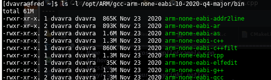

These are the ARM compiler files in my system:
index.php/fa/40897/0/
Note they are in (path) :/opt/ARM/gcc-arm-none-eabi-10-2020-q4-major/bin
And all are preceded by (prefix) : arm-none-eabi-
These, of course, change depending upon where and what you have.

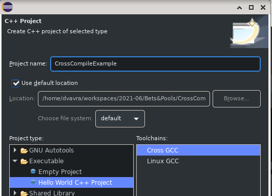

1) Select File-->New-->C/C++ Project-->C++ Managed Build
(or File-->New-->C/C++ Project-->C Managed Build if you prefer
2 ) you will get the following dialog.
Make sure to select the cross-compile toolchain

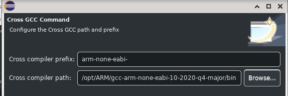

3) After hitting Next a few times you come to this dialog
Note how the prefix and path values are set.
index.php/fa/40900/0/

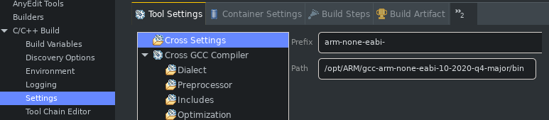

4) You shouldn't have to change the tool settings.
But the path and prefix can be modified if needed.
index.php/fa/40901/0/

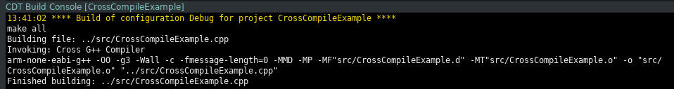

5) When you build, the cross-compile path will be prepended to the environment path
and the prefix will be prepended to the appropriate compiler, linker or utility name.
index.php/fa/40902/0/
