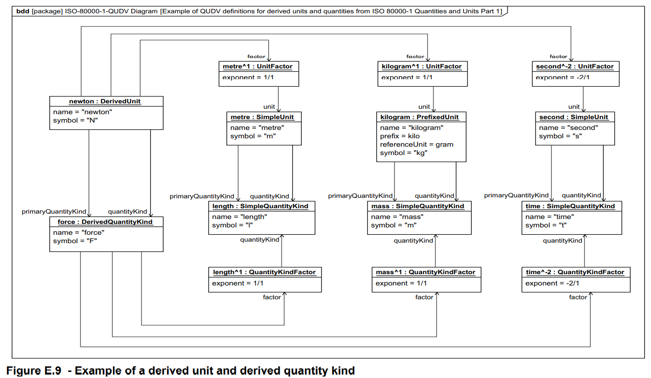

My question then is: how does one assign the factor, unit and (primary)quantitykind, as shown in Figure E.9 of OMG' s System Modelling Language v1.5 document? I'll place the figure below.
I see that these relationships exist in the QUDV modelLibrary in Papyrus, however I am unsure how to drag them (?) under the newton Derived Unit.

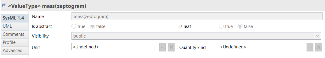

A second question I have regards the structure of the pre-existing Units, Valuetypes and QuantityKinds. Are they linked properly in the Papyrus ISO 80000 package? By that I mean for instance: Are the unit and quantityKinds of a ValueType properly defined? I see that most (if not all, since I have not checked all of them of course) Valuetypes have empty Units and QKs. An example of this is <<ValuetType>>mass(zeptogram), see image below.
In the same line of thought: Are prefixed units (or derived units for that matter) actually defined as described in the OMG SysML document? As far as I can see prefixedUnits such as zeptogram have two slots: one for the name (in an instanceValue) and one for the prefix. The latter seems to be also an instanceValue with "zepto" written in it. Hence, I am not sure if it is in any way connected to the prefix "zepto" defined in ISO 80000-1

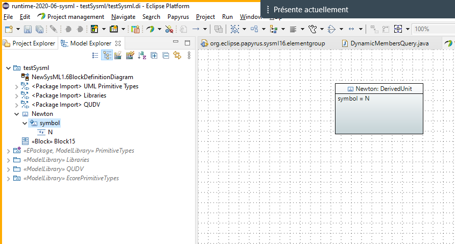

I have tried to create the Derived Unit Newton. Wow It is very long to do. you have to create an instance spec , choose the classifier Derived Unit from the QUDV library, and then create slots that corresponds to each interesting feature.
In papyrus we have no tool create automatically slots from a referenced classifier inside the instanceSpec.
So it is possible but it will take a very long time.

However, in your Newton, I see you have only added a Slot for the symbol, with its Value. If you look at the Figure E.9 which I shared in my first post, I am wondering how you would go on to create the "factor" dependency linking Newton with one of its UnitFactors? And, especially how you envision creating the "unit" dependency linking this unitFactor with its "SimpleUnit". Something similar could be said about the "quantityKindFactor" and the "SimpleQuantityKind", and their dependencies.
I see a possibility of creating a slot with as Defining Feature the "UnitFactor" property of the DerivedUnit, given in the QUDV modelLibrary. Then, a value of "1/1" could be given (if we are looking at the factor of mass for instance). But: Then you have the issue of how one should link this "Unitfactor" slot with a "SimpleUnit" called mass... As far as I can see, one cannot create a slot within a slot. And, I am not sure how to use the "A_unitFactor_unit" and the other dependencies defined within the QUDV modelLibrary.
But, to me, it seems like everyuthing is very loosly defined, isn't it? Slots seem to be the main way that was used to define the Units, QKs and ValueTypes, without clear interconnections.
