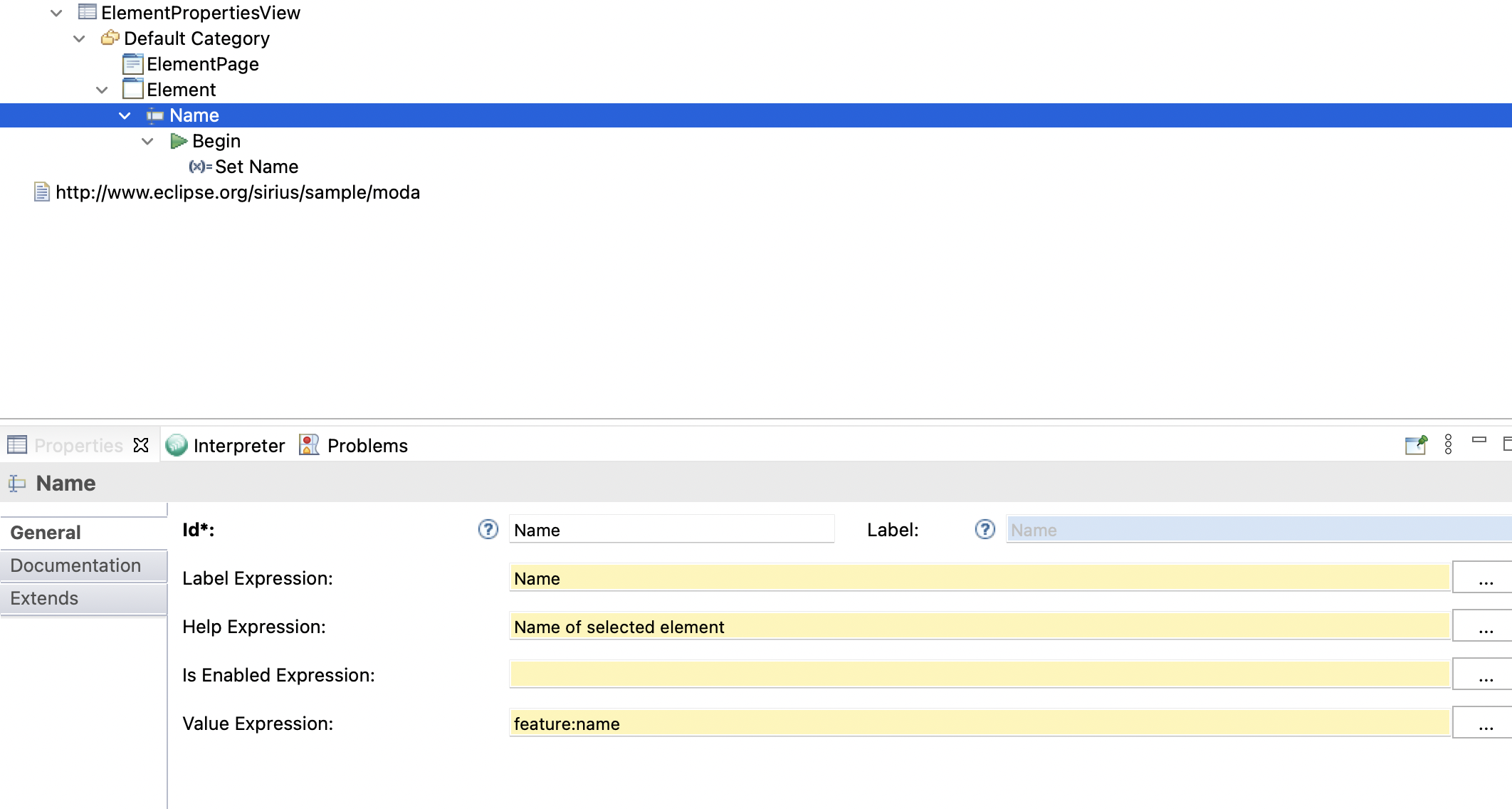

Please I need some help with the property view in Sirius.
I followed a couple tutorials and read the documentation for specifying the property view in Sirius but it keeps displaying 'no property available' and I do not know what exactly I am doing wrong.

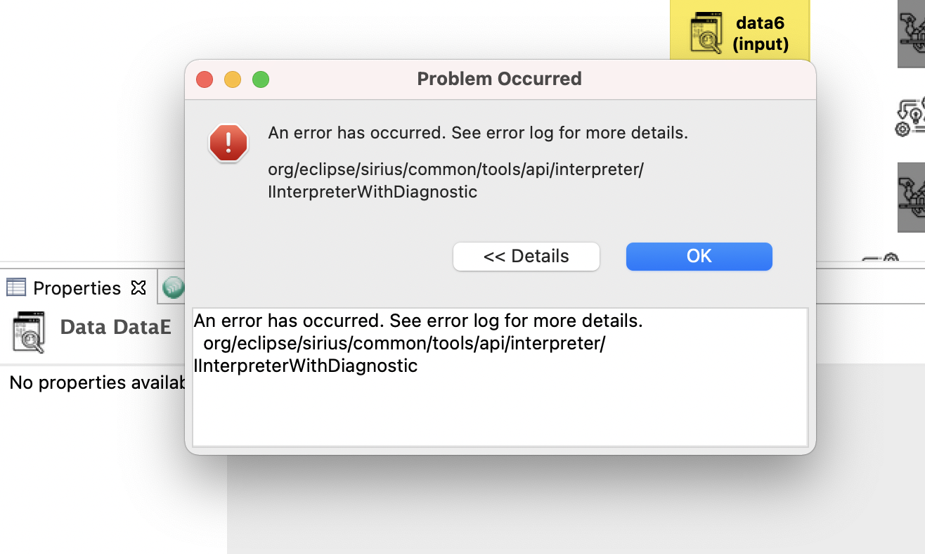

Also when I close the property tab and reopen it I get an error.
I have attached screenshots to explain more the issue I am facing.
Thank you in advance.
Mercy.

It's difficult to tell with just the screenshots. It might two separate issues.
Can you provide the actual error message logged in the Error Log view as indicated on the error dialog? ("Window > Show View > Other..." and then select "Error Log").
I just tested a very basic use case configured as in your screenshot, with nothing changed to the PropertiesView/Category/Page/Group defaults (I just added a Text widget configured as yours), and I can not reproduce the problem. When selecting an element with a "name" feature, I get the proper widget. When selecting an element with no "name" feature, the "feature:name" expression fails and I get an evaluation error, but it does not present like the one you see.
