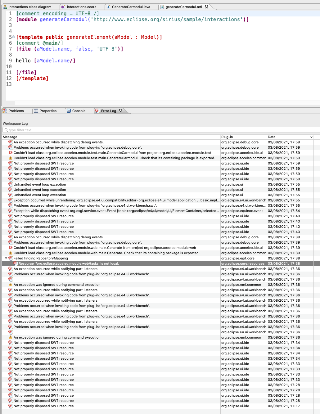

I am trying to generate my ecore file to java code. And i get a lot of error log. any one can tell me, where should i start first?

Using Acceleo has very little to do with Ecore to Java so I start puzzled as to what on earth you are trying to do and what is not working.
Your error log shows an unhappy workspace with a highlighted entry not obviously related to your Acceleo edit. The acceleo plugin problems are more likely to be relevant,
But Acceleo and many other tools malfunction in an unhappy workspace, so I can only suggest that you Clean, Restart, Clean and hope that your worspace gets sensible and whatever you want to do starts to work.
Ed Willink
Re: From Ecore to Java [message #1844075 is a reply to message #1843520] Tue, 31 August 2021 05:06 Go to previous message
I'll second Ed in saying that there are too many errors in your log to determine what the root cause of everything could be. The only Acceleo issue I can see here is the "Couldn't load class" message, which usually indicates that the package containing your "main" module is not exported. Please open the META-INF/MANIFEST.MF file from your acceleo project, go to the "Runtime" tab, and in the "exported package" section click on "add" and double click the package containing your module file and its associated generator.
